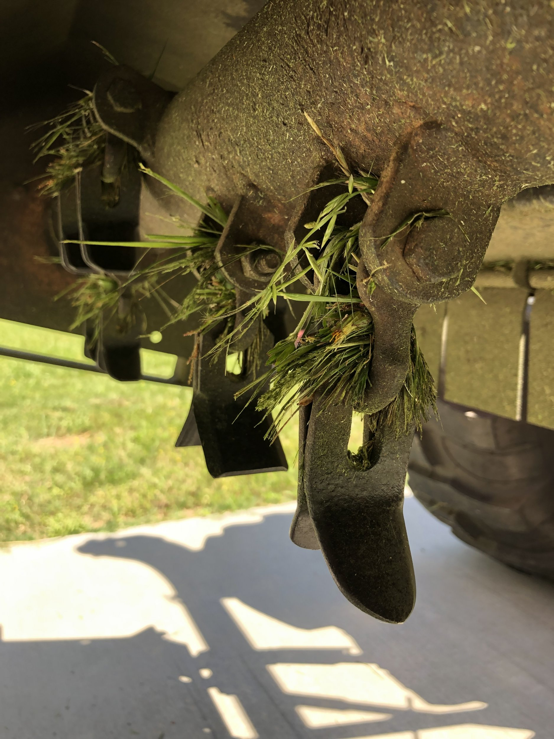

I have posted in the epic flail thread but thought I’d start a new one. (Thanks for those responses.)

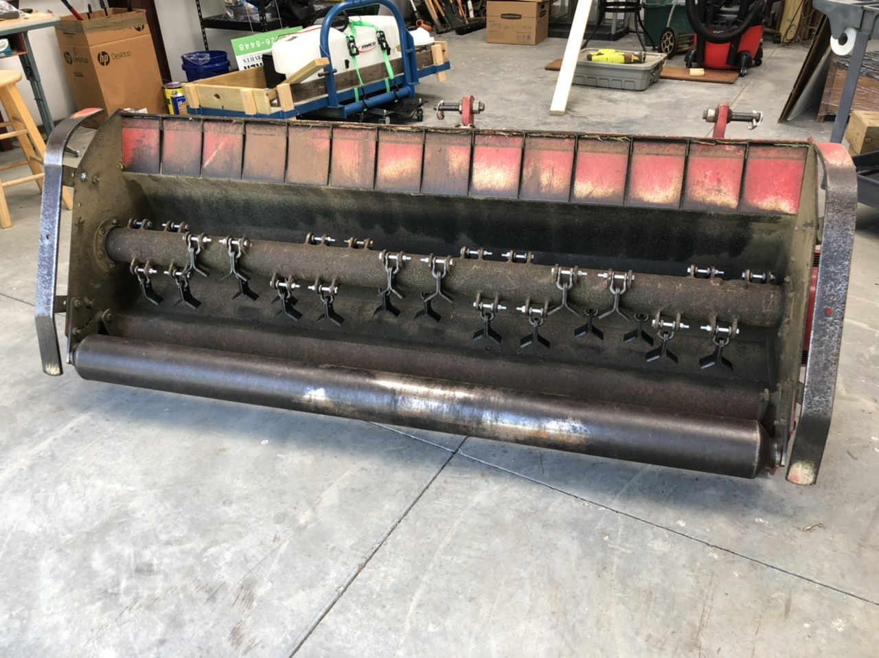

I inherited a seemingly solid 12 year old Caroni TM1900 flail mower, 73” cut with the Y blades. 28 stations with 56 blades attached by a clevis, bolt, and nylock nut. Strong evidence suggests it was misused and never setup properly for the conditions it was used in. Rear roller and side skids were at their highest settings to get a short cut so the blades spent a lot of time in the dirt and smoking belts.
Some blades & hardware have been replaced over time with the originals (?) having been reversed. I want to replace them all and cry once. Agri Supply is the US distributor but their parts are super expensive. So I recently contacted Flail Master and ordered a sample set of their Caroni compatible blades, a clevis, bolt & nut. I’m headed out now to test the fit and if all goes well I’ll order a full set from Flail Master. My project for the day.
Agri Supply blade $8, clevis $17
Flail Master blade $2, clevis $11
Overall about $600 vs $1300

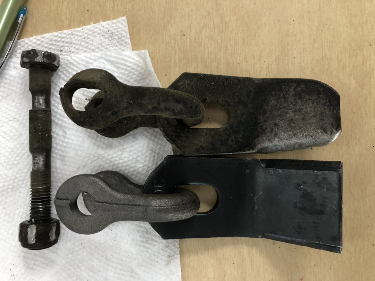

An old & newer existing blade. Little ‘meat’ holding many on.

The FM blades aren’t identical to a Caroni but everything fits. Blade holes are the same size & shape. All other dimensions differ a bit. Both weigh 4.4 oz. Clevis is good and I was told made in Canada. Bolts & nuts are from China. 80x10x1.5 mm, grade 8.8. FM suggested replacing them all to maintain balance. Understandable and good for sales too.

I don't do much metric stuff so not sure how an 8.8 bolt compares to SAE #'s, but I would be careful using any bolts that're Grade 8 or equivalent - the extra hardness ALSO comes with extra BRITTLENESS, where a grade 5 isn't as hard but IS "tougher".
Edit - nevermind, 8.8 is apparently equivalent to a Grade 5

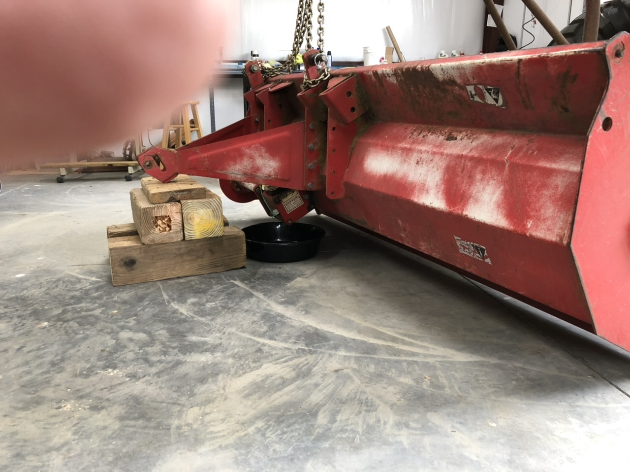

Good to know about the grade of bolt they supplied. I was wondering if a grade 8 equivalent wouldn’t be better. Appears not and I’ll stick with the FM 8.8 metric. My shop is pretty wimpy compared to yours. I’ll probably try to flip mine over on its back and might take the grinder to the bolts. I have a plug to fit the gearbox filler hole to hopefully prevent a mess.

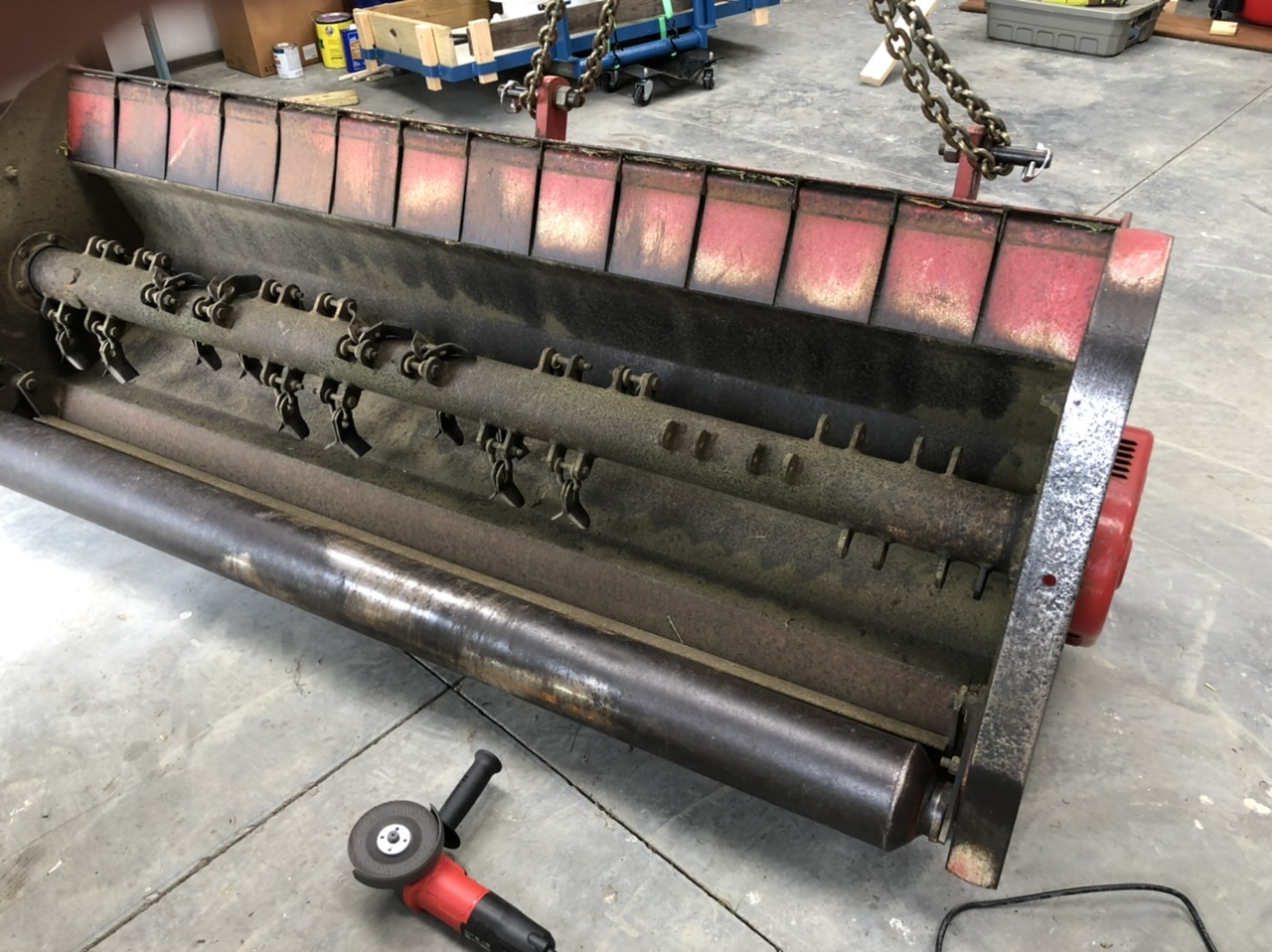

An update. I managed to flip the flail over on it’s back using an old 3pt boom pole I dug out of the weeds. (FEL is back ordered). Very careful not to maim myself. :unsure: I am supporting the top 3 pt tower with cribbing to keep any weight off the gear box. I temporarily plugged it’s fill hole so no drips yet. Working like a charm using an angle grinder cutoff wheel. I definitely would not want to try to reuse the bolts & nuts IF I could have gotten them all off with the impact. Nuts & bolts coming from Fastenal for $2/pair so a no brainer there. Hopefully all parts come in tomorrow.

I ordered M10-80mm bolts because that is what Agri Supply sells as a Caroni replacement. Ideally 75mm length would work better and is what originally came from the factory. I had to hacksaw a couple of bolts by 1/4 inch for the outermost stations.
I spent more time mentally trying to figure how to flip it over by myself without damage to it or me than the actual work. Lift it slowly by the two lower hitch pins and it will want to roll over backwards nicely. I then supported the top link tower to keep any weight off the gearbox and to prevent it from rolling too far.
