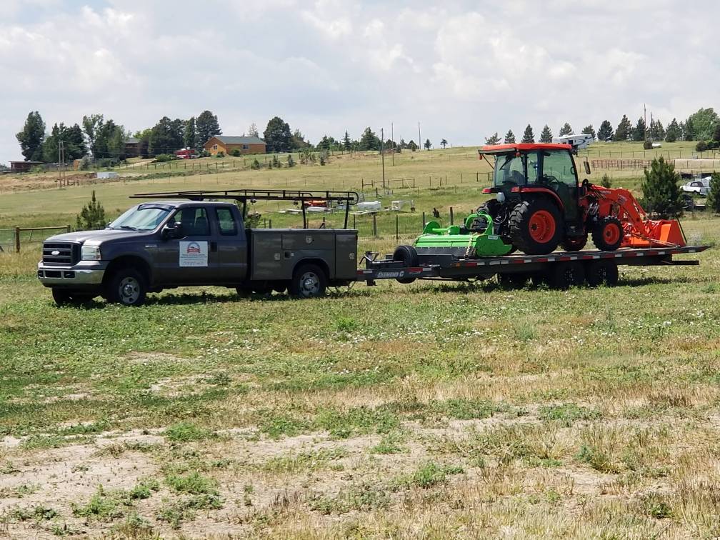

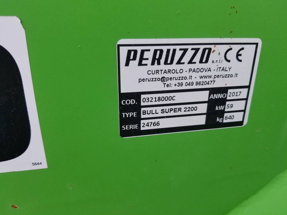

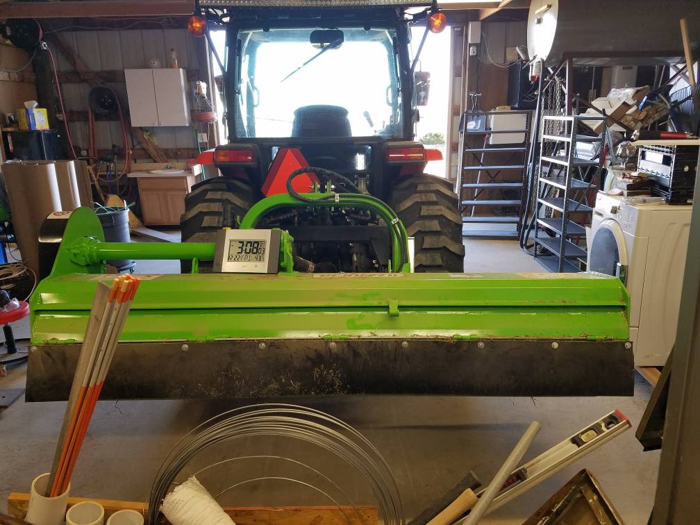

I have a Peruzzo Brush Bull 2200 behind my L4060HSTC (40hp engine, 5-6k ballasts with the loader). It's got a 7' working width. A decent bit overkill but I like it. I'm a fan of wide & slow. You cover the same ground but are bouncing around less so it's easier on your machine & back. I have hit more rocks than I care to & have no damage so far. I recently got new hammers & realized mine havent dulled really, the new ones are equally un-sharp.
No issues with stability at all even shifting things around while raised. The loader will barely pick up the 1,700lbs mower but the 3pt handles it fine. 20180618_122127.jpg20171222_150735.jpg20190504_160950.jpg

THANKS! My tractor isn't as heavy as yours but, real-world feedback like this is super helpful.
