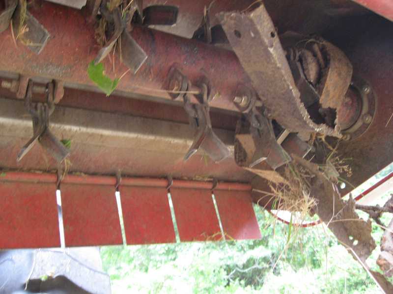

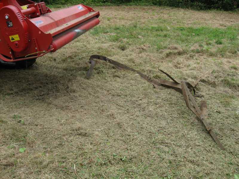

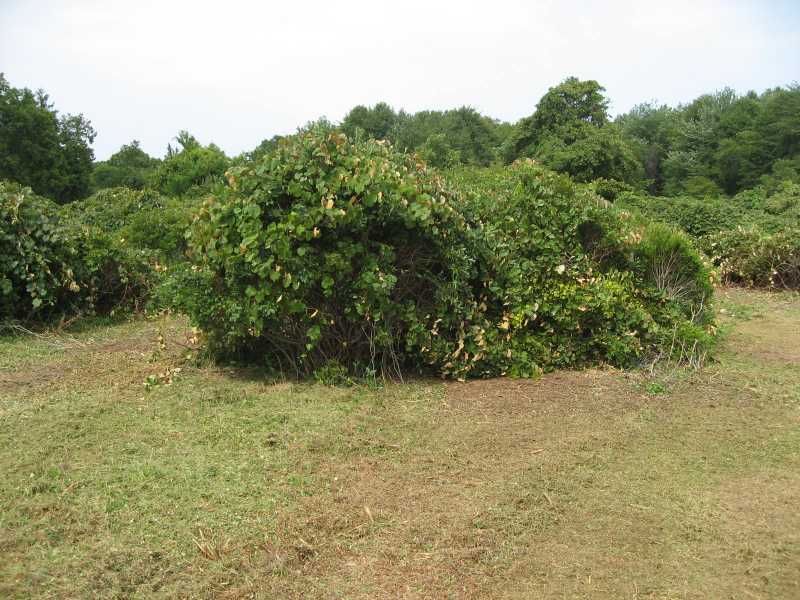

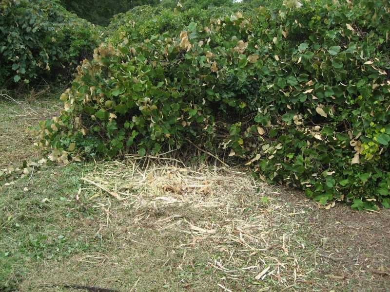

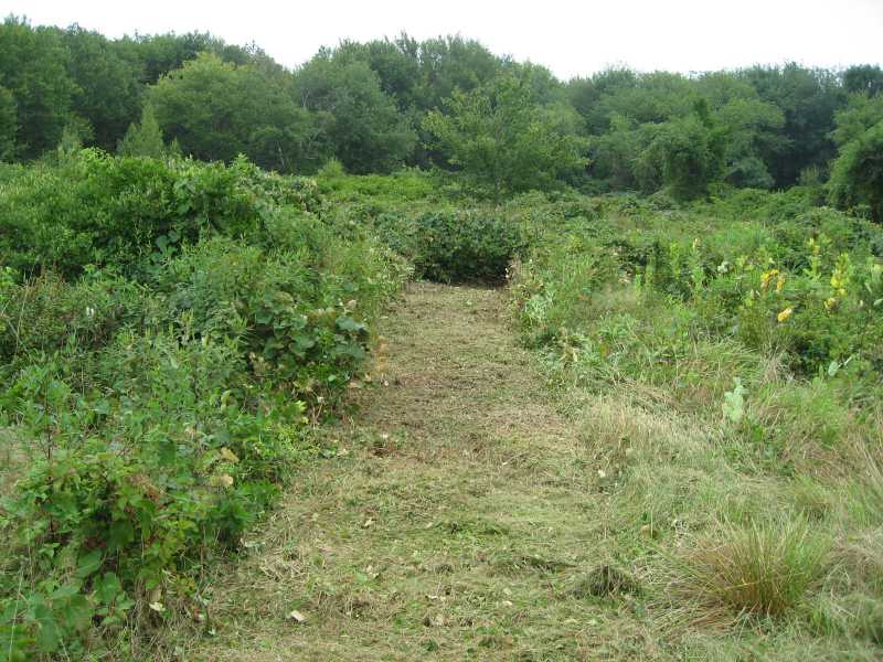

Here are some photos of things I have intentionally and unintentionally cut with my TM1900. So far there has been no damage to the flails despite run ins with a car frame, tire, car spring, and what I presume was a rusty car fender or some sheet metal part that was shredded. I've leveled bushes with stalks up to 2 inches in diameter with no issue at all. Pulverized a few rocks and pieces of concrete too. Only damage to date was to the rear roller which is really just a guide and I damaged that by hitting a pointed rock while moving pretty fast. Doesn't affect function at all and I think of it as similar to the bulges in the side you see in rotary cutters after they throw rocks.
The photos don't have captions but I think you can make sense of them. The first photo shows a bush that I have cut around with the mower and then the next one shows what happened when I backed the mower into the bush. The old car frame photos show it wrapped around the mower...took about 10 minutes to unwind, and then the piece of metal afterwards. The last shot is just an example of the type of cut you can get by simply making a single backing and then driving forward again into thick brush. I keep the mower low and find even one pass is all that's needed but when I back in and then drive out it really leaves a very clean surface. Much cleaner than a bush hog as it pulverizes brush into much smaller mulch. No 6 inch sticks laying about like with a rotary cutter.
