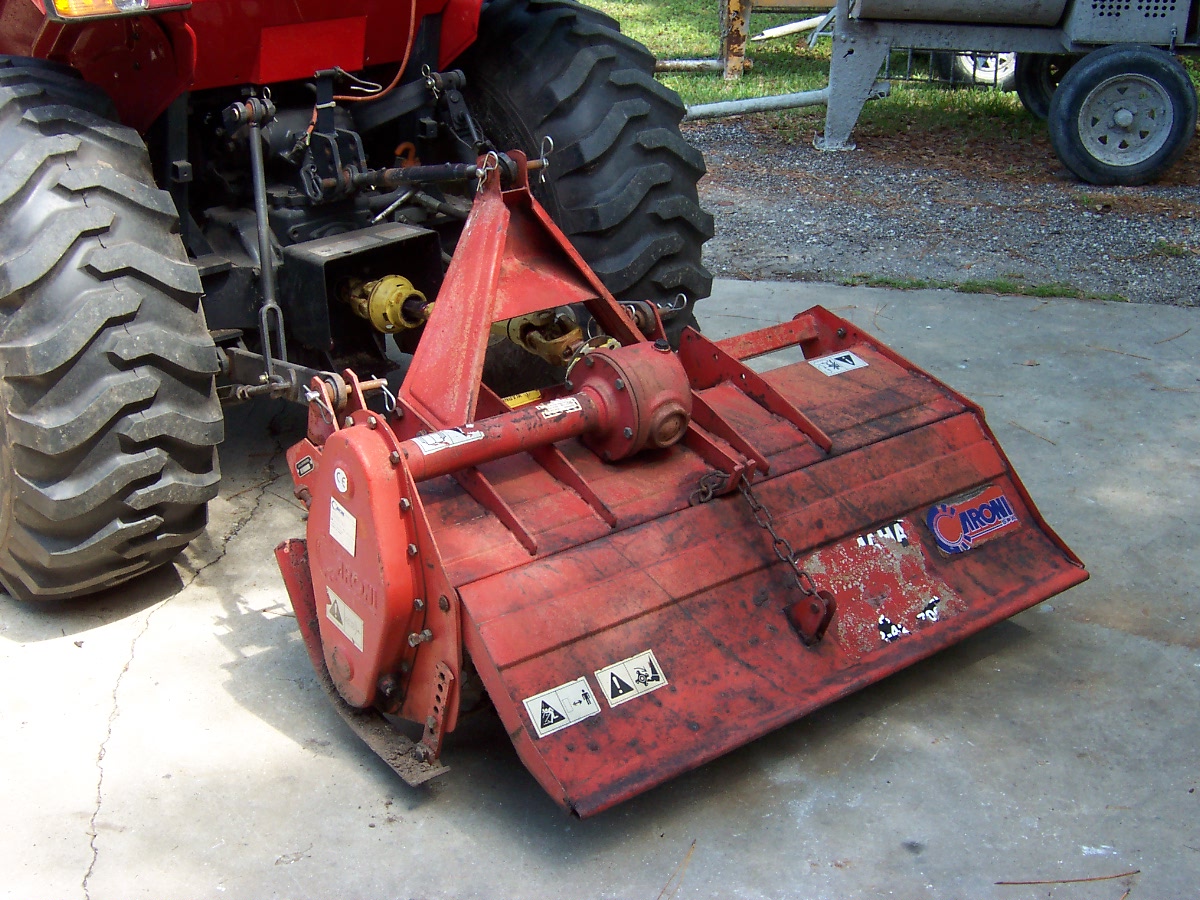

My Caroni 4' tiller does an excellent job. I bought it used last spring for $600. I used it today to pull out a row of cabbage that has all been cut.
