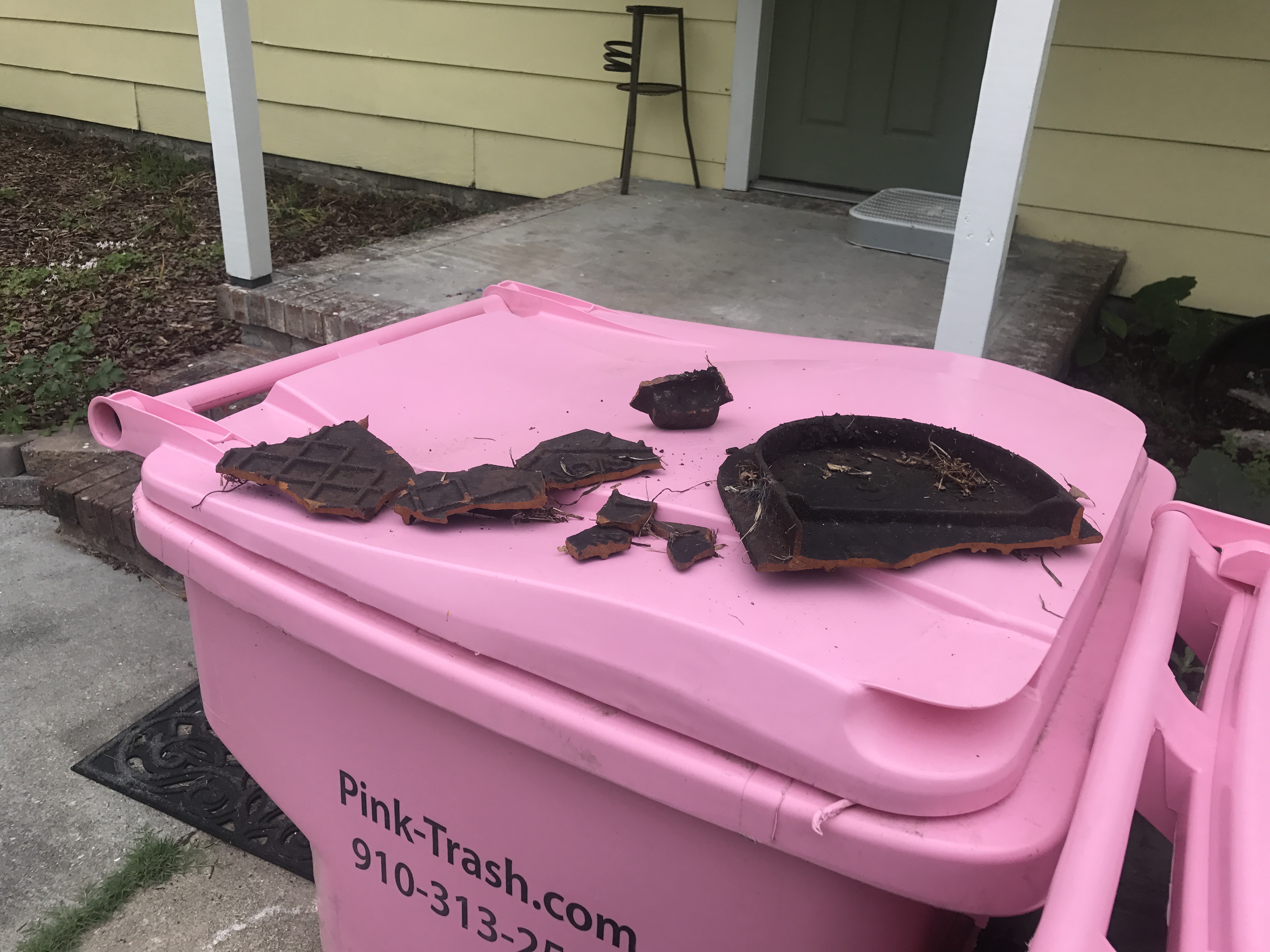

The pressure gradient on this little guy is no joke at the lower cutting heights I've previously works with. I think it sucked up a probably 10-15 pound, if not more, cast iron, water meter cover and absolutely obliterated it a couple weeks ago. I don't believe the mower was set low enough to catch it with the blades so I'm assuming it got enough pressure into the finger hole on it, pulled it up, and the rest was history in a matter of seconds until I realized what happened.

Probably the low pressure area (where the flails are rotating up?) sucked the cover out of the fixture. F1 and Indy cars with lots of aero wings have been known to suck heavy manhole covers out of their fixtures on street circuits... sometimes even when welded down.
If you think about it the hammer shaped flails will move a good amount of air.
It didn't damage the mower? I'm impressed!
