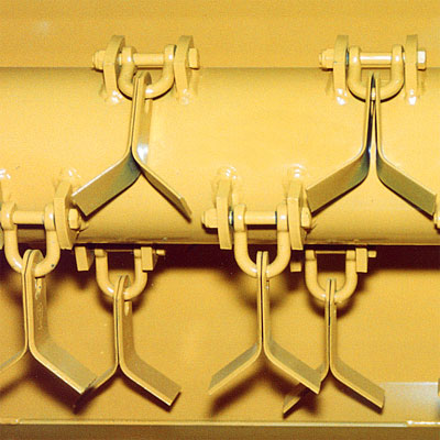

I believe that blade is a medium duty blade. Yes it will cut grass very well, and weeds and rough stuff. I have the fine cut blades on mine, and I try to stay away from heavy weeds, small trees, etc, as it will beat up the cutting edges taster. I replaced 176 blades on mine. 88 stations 2 blades each. Sharpened on both sides. Someone was asking about the overlap, and you can see the overlap in this picture.
On your one blade, does that single blade overlap any , or is it just as wide as the double blades?

Assuming you have the 56 shackle version;
I hope you noted that there is an apparent mistake on the assembly of leftmost one ?
Just a reminder for when you put them back.
For anyone who doesn't know, or hasn't noticed yet, they both face "inwards" like a pair of letter "L"s like this "LL" but tighter together.
On all the other shackles they go back to back, kinda like thin cheap sheet metal bookends with no books between them.
How I know ? I made the mistake of "correcting" what I thought was an assembly error.
It only took one jam to teach me that the folk at the factory probably knew what they were doing.

J J and I were posting at about the same time.
If I had seen his picture before I posted I might have worded things differently.
Anyway, what I described as "L" shapes are in fact opened out more than that, about 135 degrees not 90.
The ones on the extreme left shackle don't go back to back, they both go right.
:END EDIT

Reg, were you talking about the picture that I posted? If so, that is a reference picture, not my flail, although mine is similar.. Now that you mentioned it, I don't know about the outside blades. I will have to check. If I remember right, I had some space past the last hanger, but if I see things beat to he**, then I will know.

ALL the blades on mine were on back to back. I'm 99% sure. (I always leave that one percent just in case)
