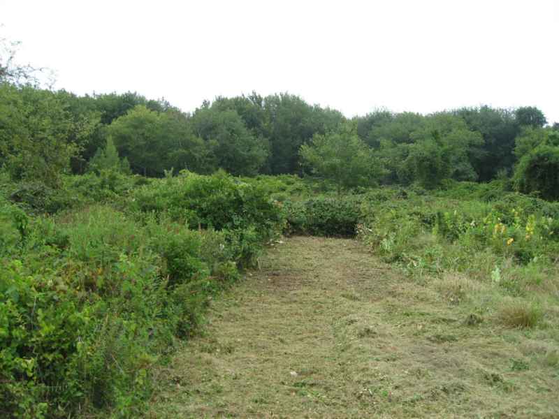

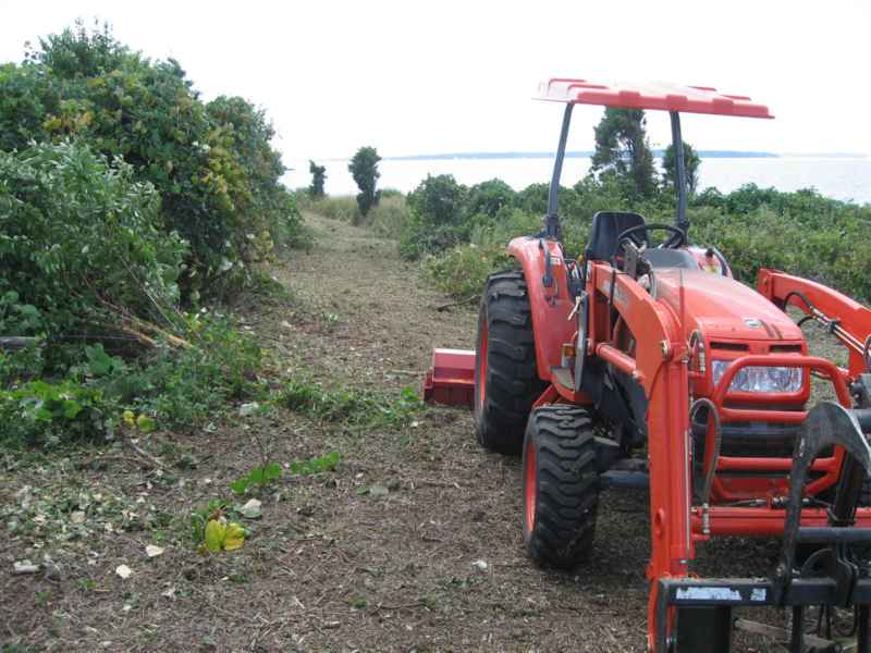

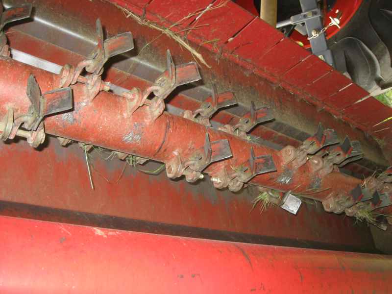

I own a Caroni TM1900 which is the bigger and heavier duty version of the TL1500. It still costs about half or even less than half of a Befco so I gotta assume the Befco is built even more sturdily. That said, my TM1900 has chewed up tires, springs, metal frames and chunks of concrete without a problem. It gives a great cut too.
If I were operating a mowing service to cut highway medians I think I would buy one of the very heaviest flails I could. For regular use, it's hard to beat the Caroni for price/performance.
Mine has the "hammer" or Y shaped blades. The TL has a finer blade intended more for grass. Personally, though I use mine on a 41hp tractor, I wouldn't hesitate to put it on a 30hp machine.

ArtVandelay said:
And are the "Y" shaped blades the most heavy duty type?
No, but they are what you want for grass.
The most heavy duty type are these:
Followed by these:
Then "Y"s and
then "L"s.
