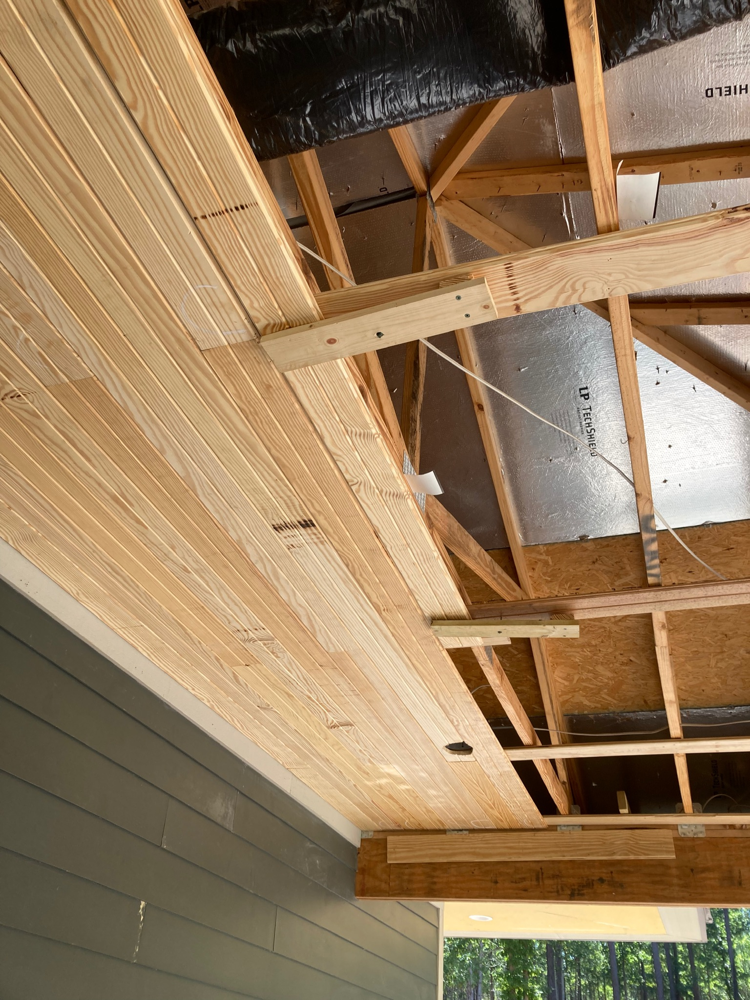

I'm putting up ceilings in 3 outside porch areas. Im using tung and groove material, 12 ft long with about a 5 inch reveal. I guess it's about 5/8ths inch thick?
I'm doing it solo so, it's a PITA! I wish i'd gone with ship lap. Getting the tung into the groove across a 12 ft board, 10 ft up, by yourself, is difficult.
I wish i could say this was my idea but.........it wasn't. U tube.
My carport is 20 ft deep so a 12 foot board ain't gonna go end to end so no ledger board. I've been trying to stagger the joints so i use a combination of 12 ft, 4 ft and 8 ft boards.
The big problem is when the 12ft board falls in the middle of the 20ft run. It sags on both ends or sags in the middle, it's a 2 man job.
The guy on u tube suggested using helpers so i tried and it works.
Still a huge PITA and 8 ladder climbs per board but....it works.
You install the helpers loosely, allowing enough room to slide the board onto the helper. Then, after getting everything lined up, screw down the helpers which brings your tung and groove material very close to where it needs to be.
Then beat the piss out of it, being careful to use a whacker board, like when you do flooring.

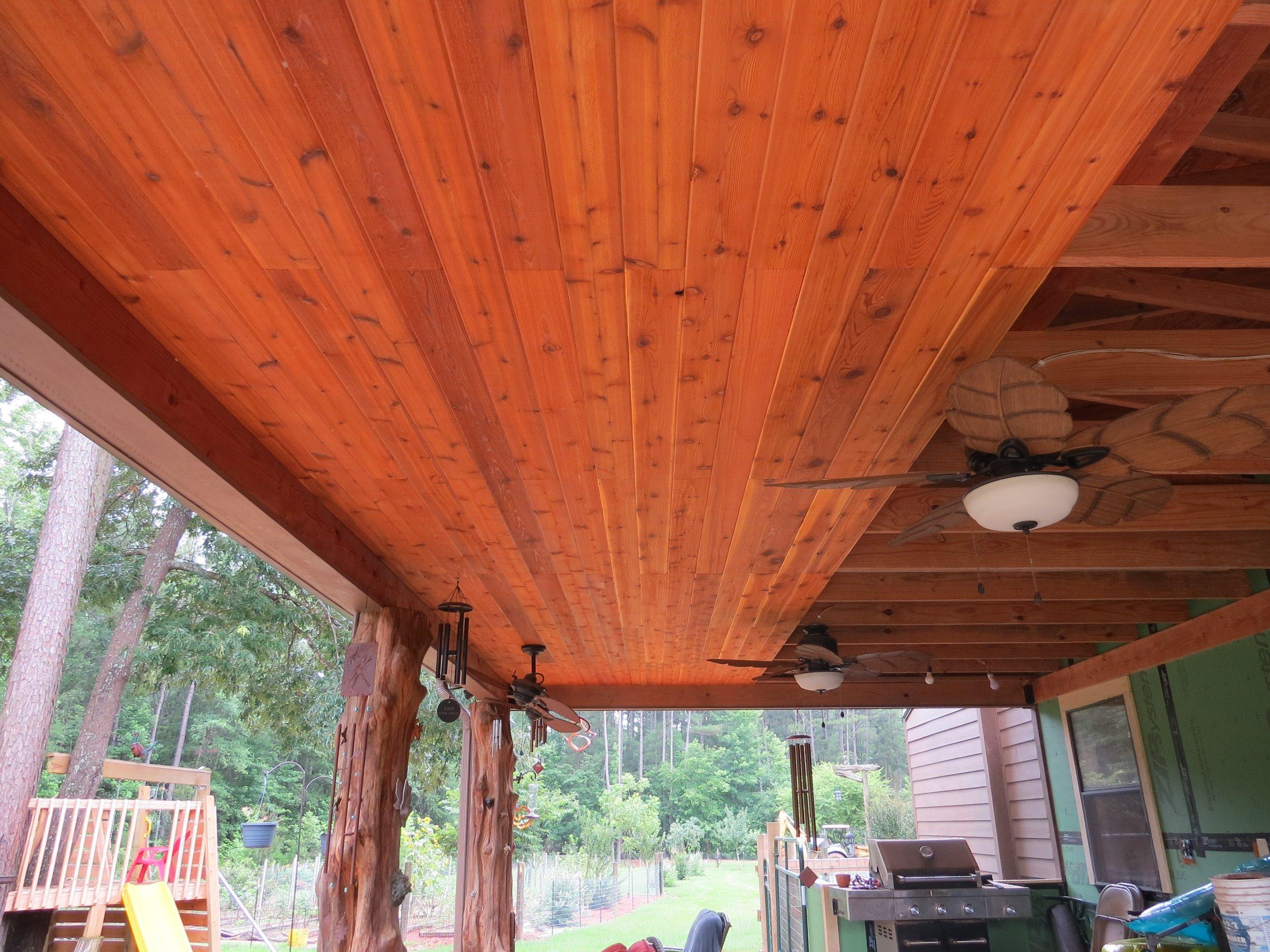

I'm also putting tongue and groove wood on my porch, but I made the mistake of going with cedar. I'm also using 8 foot boards, which are super light and easy to install. When I started, they where $14 each. They disappeared during the shutdown and it's been very hard to find them since then. I just spent $750 for some that I found at Home Depot for $28 each. My porch is 16x24 and I'm almost at the half way point.
When I do tongue and groove ceilings, I like to seal the boards before I install them. Doing them in place is a huge mess that I've learned to avoid. On my cedar boards, I'm using Sherwin Williams SuperDeck transparent oil based stain. I cut the board, apply the stain, and install it with my staple gun. It's tedious, but goes fairly quickly.
