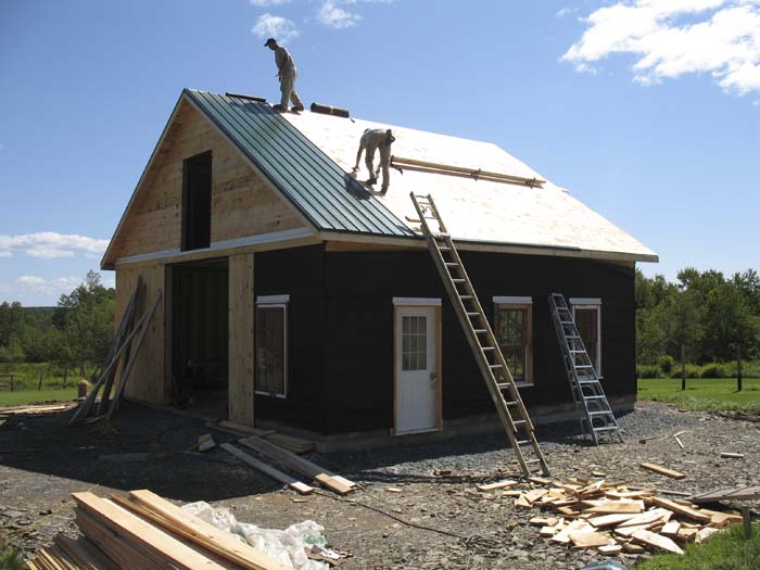

We built a barn possible carriage house last year - search Lloyd Barn Project.
The footprint is 26.5'x30' with second floor loft. Exterior finish is board and batten with metal roof with sky light panels. It has a concrete pad with radiant floor heat - one zone for tack room and the other for the remaining section of the barn. The second zone will be used only when it no longer is a horse barn and becomes a work shop.
There are two 10'x10' double sliding doors on the gable ends.
Cost including rough road plus site prep and building is well under $30k.
Walls are 2x6 with boarding-in plus board and batten.
Lloyd
