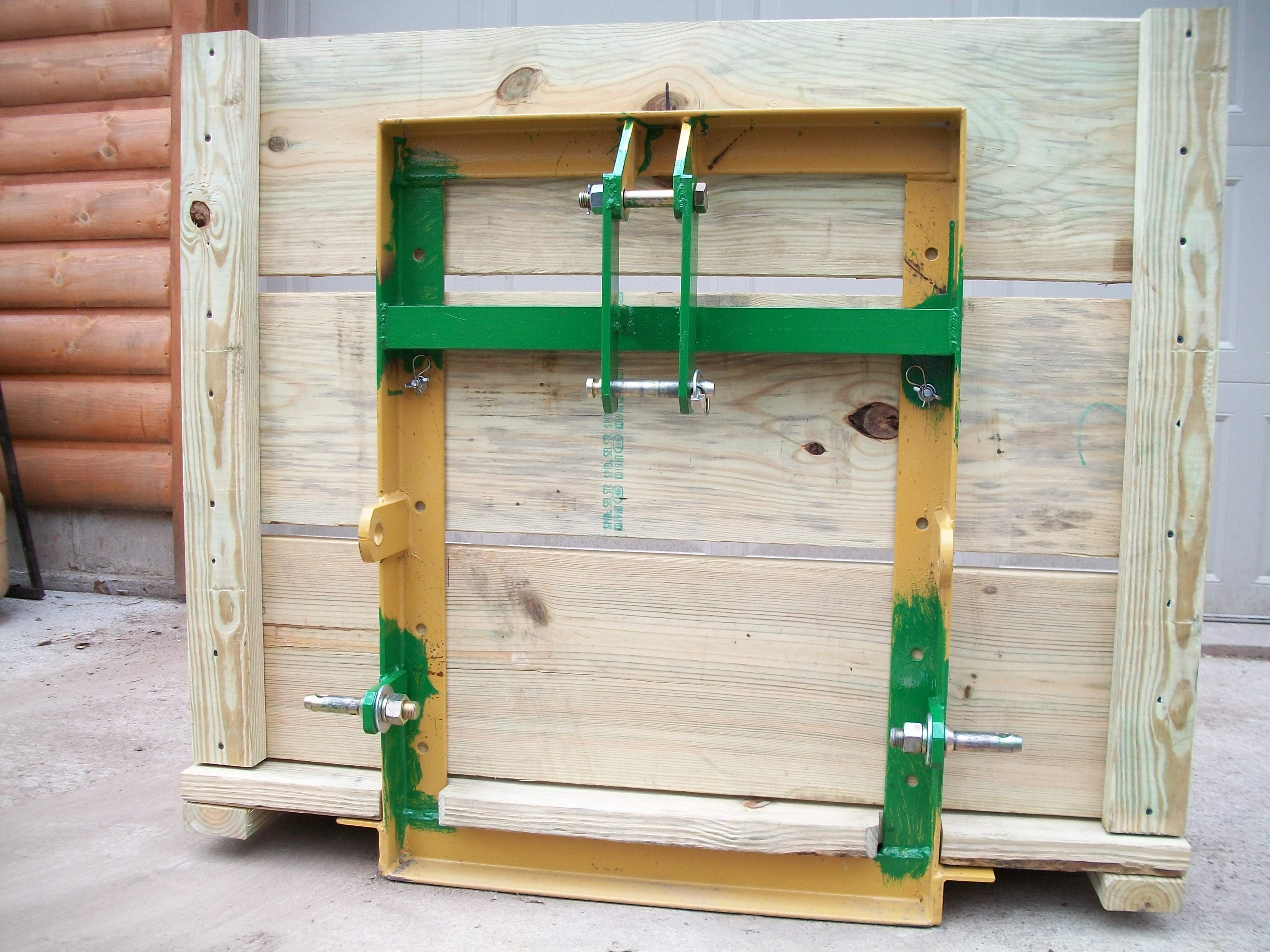

Here is my carry all. Just a standard TSC carry all that I built a two piece deck and back board that are 3' long by 4' wide out of treated pine.
I found with my lifting capacity this is plenty big enough. With my tractor I found I could lower all three connection points 9" and it would raise the deck almost to tail gate level of my pickup.
............... Hardest part may be getting a picture to attach........

Wyobuckaroo, I like that..... I see the orig holes and upper attachment pin. Is that what you raised 9"? Also, how much weight do you think that would lift? thanks

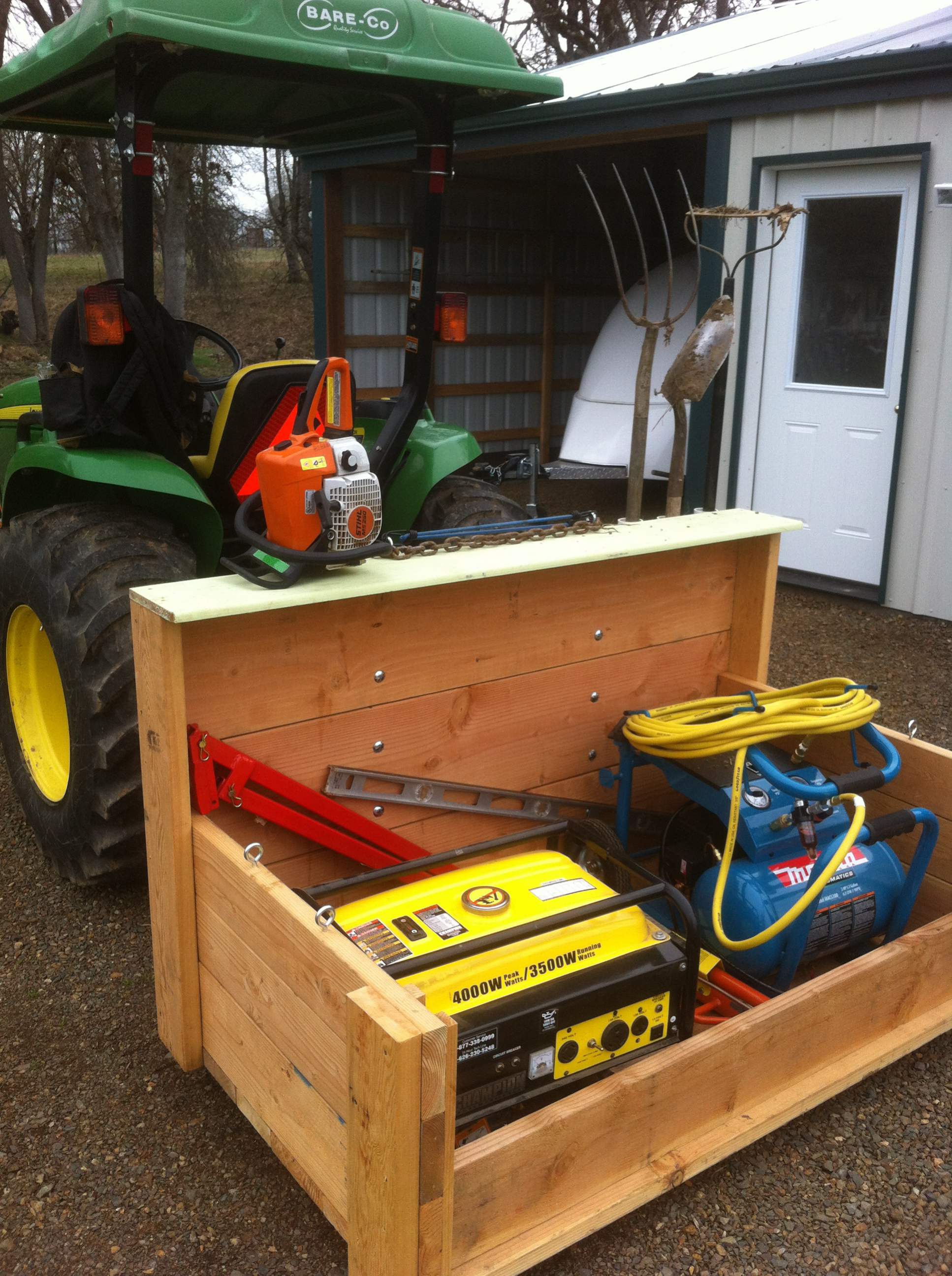

Here's a pic of mine. Got a lot of fencing projects so it needed to carry both a generator and compressor to drive the tpost pounder. IMG_0034.jpg

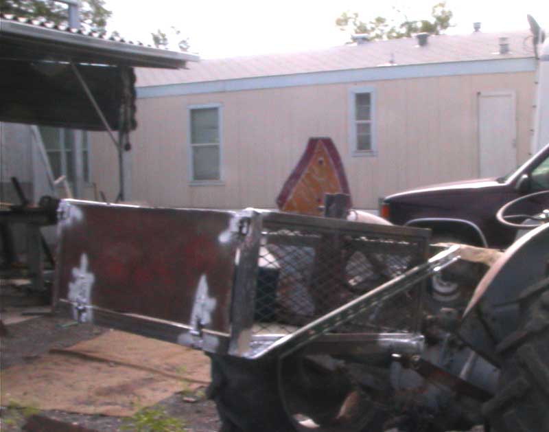

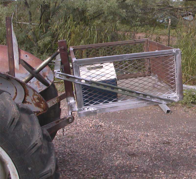

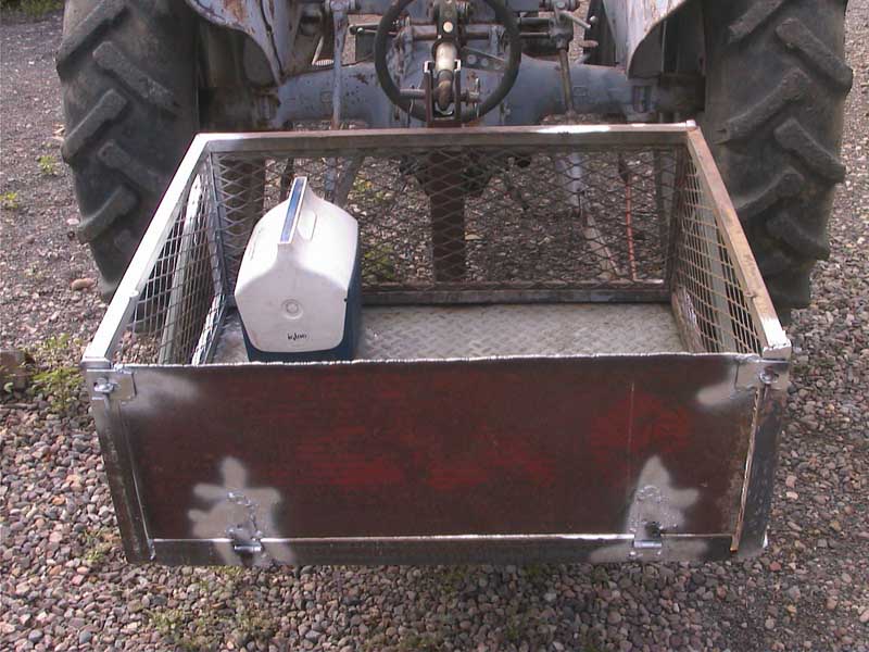

Here is a little quickie built for a neighbor a few years ago. Took about 3/4 hours.
Bottom is 1/4" diamond plate and it is strong enough that a small trailer could be towed with it.
I offered to paint it pink to match his undies. For some reason he declined. :confused3::laughing:
That is exactly what I am going to do. I want it to reach to my pick up bed. I am getting some materials on Monday. That really looks nice. Very good job. Was this your idea, or did you see it somewhere?
