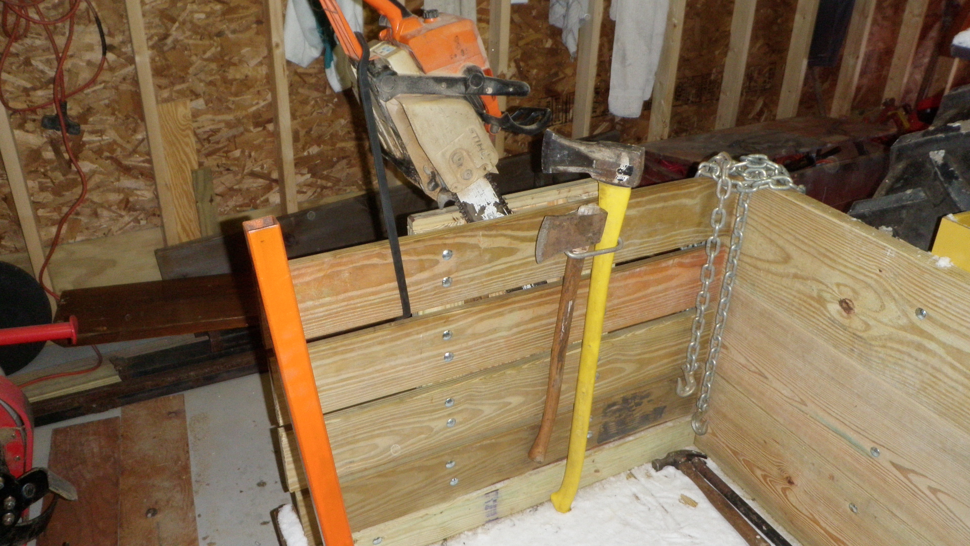

Added bobbles to the carry all, and then tried it out to see if any of it worked.

Any more details of the construction? What did you start with for a Carry-All? Yours is built with higher quality than most 'Mainer Versions' that I have seen. Dang... you just created another project for my ever growing list.

I bought the frame for the carry all from TSC in Scarborough, and them added 2X10's to the frame, I made the sides out of PT decking bolted to PT 2x4 reinforced with metal corners, 2 removable stakes for the rear to hold 4 foot length wood, added to chain saw cradle with file holders and axe/maul holder. I've used it for 2 days and it's working out to be quite handy. Not quite heavy enough of a ballast for the plow, but I'm sure it weights nearly 400 pounds.
Plenty of 'Downeast Roofing' here in the Mid-Coast as well.
