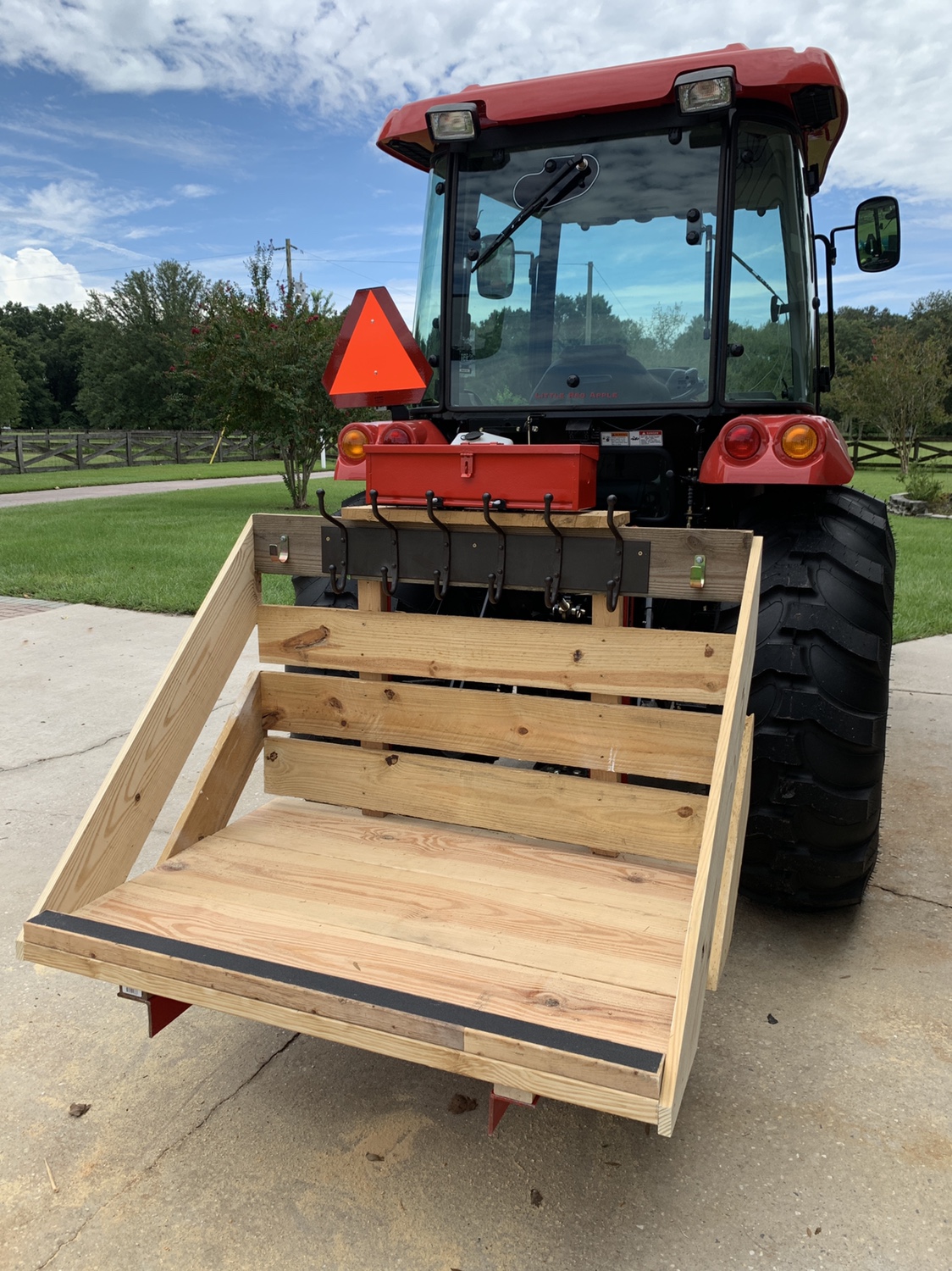

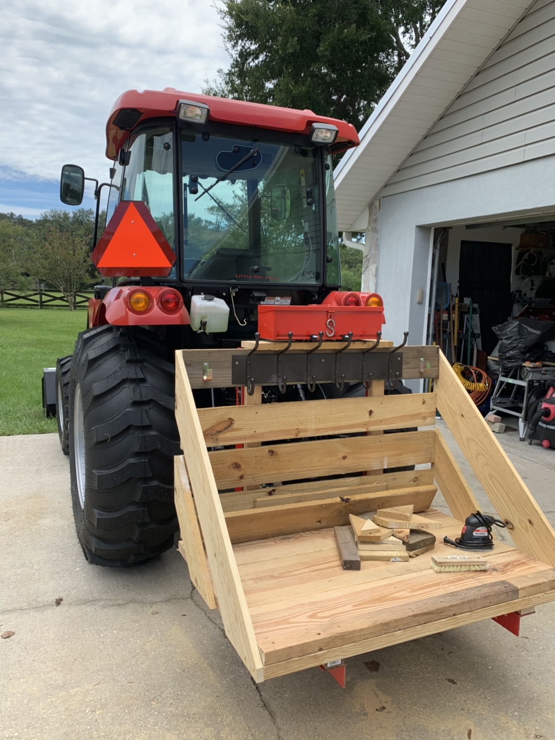

Worked on a little something today.
Tomorrow I’ll actually try and do some work “with” the tractor.

Not too bad. I would add metal brackets to the corners instead of relying on nails or screws holding up in to the end grain of those 1x's. Or just run a 2x2 vertically inside each corner and screw the 1x's into that.

I used the wood because it’s what I had laying around from another project. I don’t plan on leaning on the side pieces, but it should help hold things from falling off the edge like a box or five gallon bucket. I like the metal bracket idea. I used lag screws and three inch deck screws.
Hopefully it won’t rot, I plan on taking care of it.

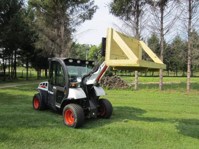

The toe board at the edge is really handy so you can "feel" the edge with your feet. Does your tractor have a quick attach bucket? If so, you can get a SSQA to 3pt adapter so you can use it on your FEL.
