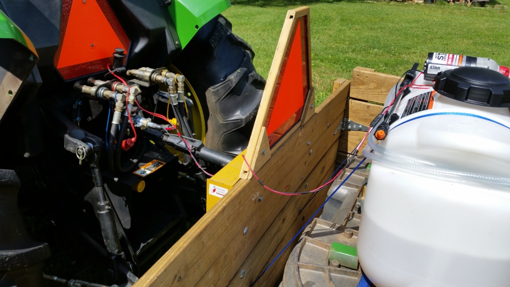

/ Carry all Question... #7
My carryall is 5ft 6in wide. It has 3 sides, I use it to carry fire wood, I put a tarp on the front and put raked leaves in it and various yard waste, I mount my 25 gallon yard spray in it. Use it to carry things that are too heavy for me. Use it to carry around tools. In the winter I keep it in the basement and put firewood in it.
I put wheels on it, so it is easy to move around.

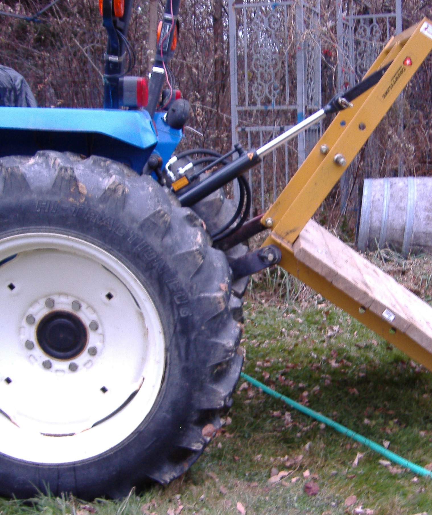

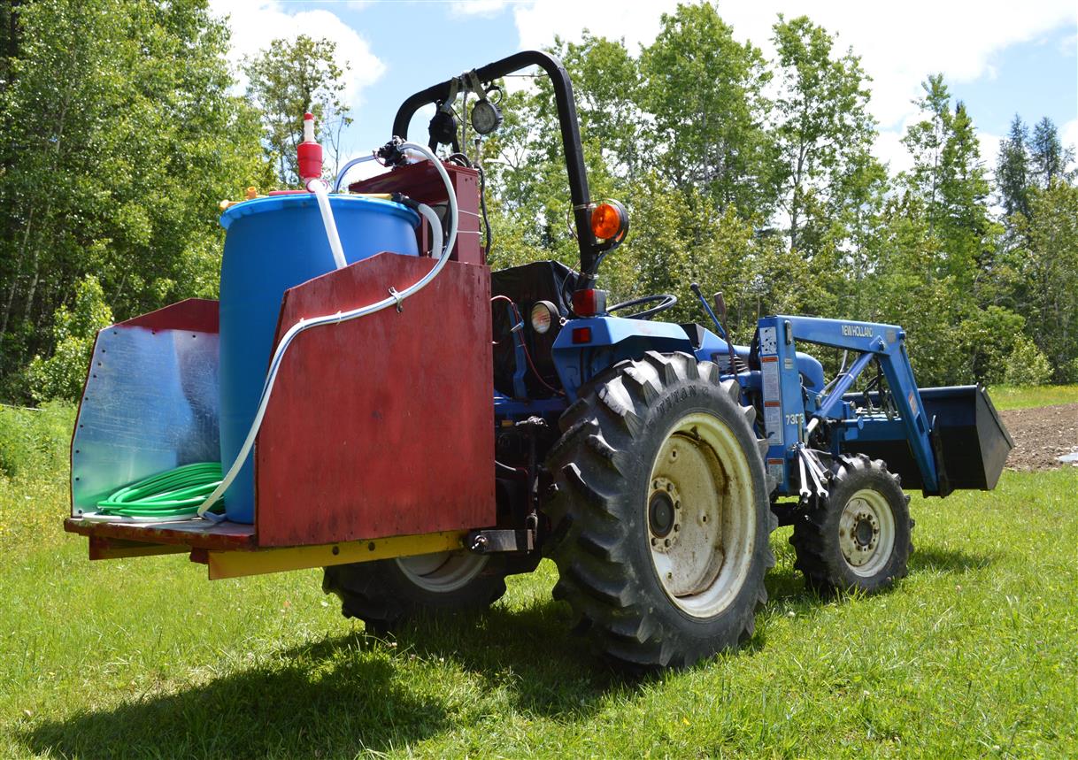

/ Carry all Question... #8
I took the same frame and redrilled the 3 pt pin holes lower. I put a hydraulic top cylinder on it. That gives me the ability to dump. I filled in the sides and use it for miscellaneous stuff. Here it is with a 50 gallon water drum and elec pump off the tractor for the garden. I like the dump because I can get rocks and dump them or fill it with manure and dump it. - I used to use it for wood, now I use the bucket.

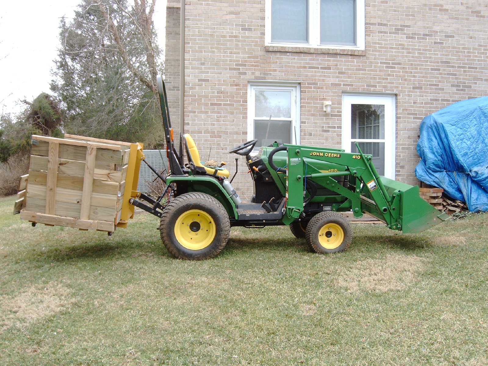

/ Carry all Question... #9
I put a pallet as the bottom part and then added some 2 bys to attach some uprights, etc. Pictures below.
Ralph
