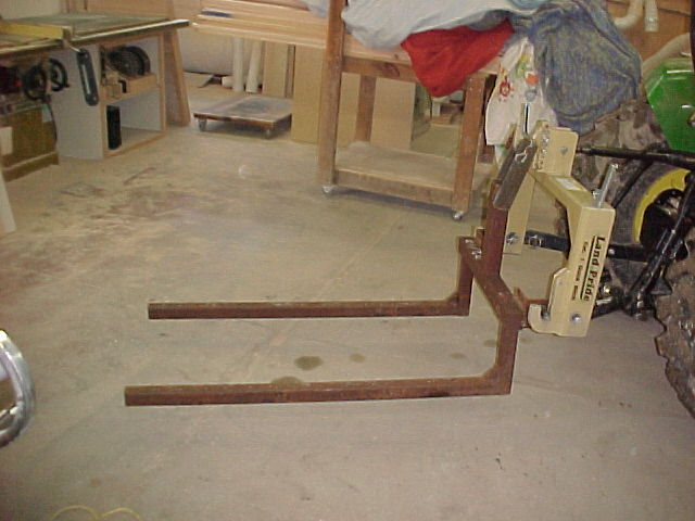

I bought a 3 point forks at a auction, They come in very handy at times.

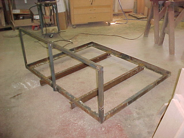

I built a fame 5' x 4' with 3" channel iron for the rear forks to slide into.

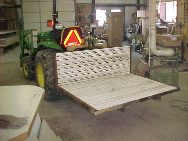

It's time for a floor.

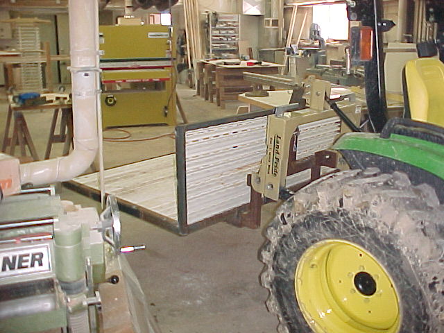

I used some plastic flooring from a old hog building. 2" thick x 5 1/2" wide. The slots in it alows snow and rain to melt and run though, so it won't rott.

Nicely done DDT! you could have a dance party on all that space. Notice there's plenty of light aimed back there also.
   / Carry-All #6
You have almost a trailer there, I bet it's real handy. I need to do something like that myself perhaps with some sides. I had never heard of plastic flooring but it sounds like a good idea. How much weight have you put on it?

I have had the forks for a year now. My old 855 would max out the 3 point at times and never bent the 2" sq. tubing. how ever my 4300 has double the lift cap. I will surely find out what it will hold in time. the carryer frame is made of 1/4" x 2" x 3" angle iron, don't think that will bend. I can even slide the forks in from the back side if I need a tail gate. I thought about stack pockets for side boards, but I mainly need several places to chain or rope things on, I guess this would give me the best of both worlds. I plan on hauling my JD LT133 mower on it and a portable work bench.
