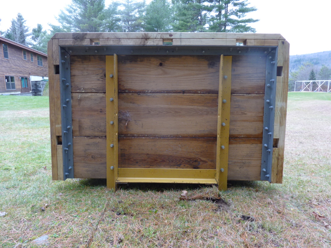

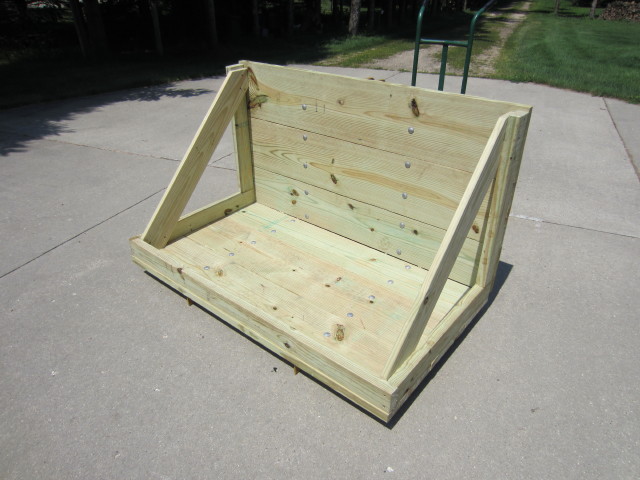

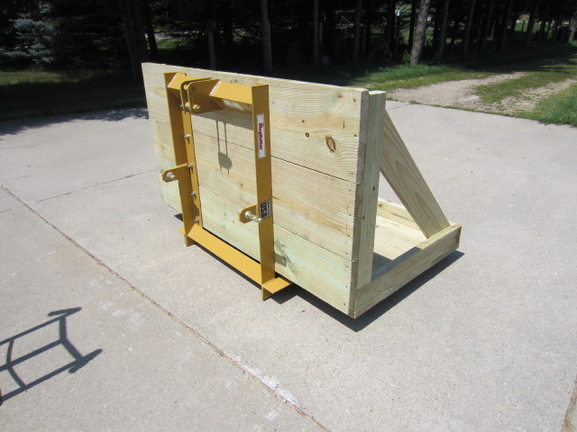

You can always put some lumber on the carry-all so it fits your purpose.

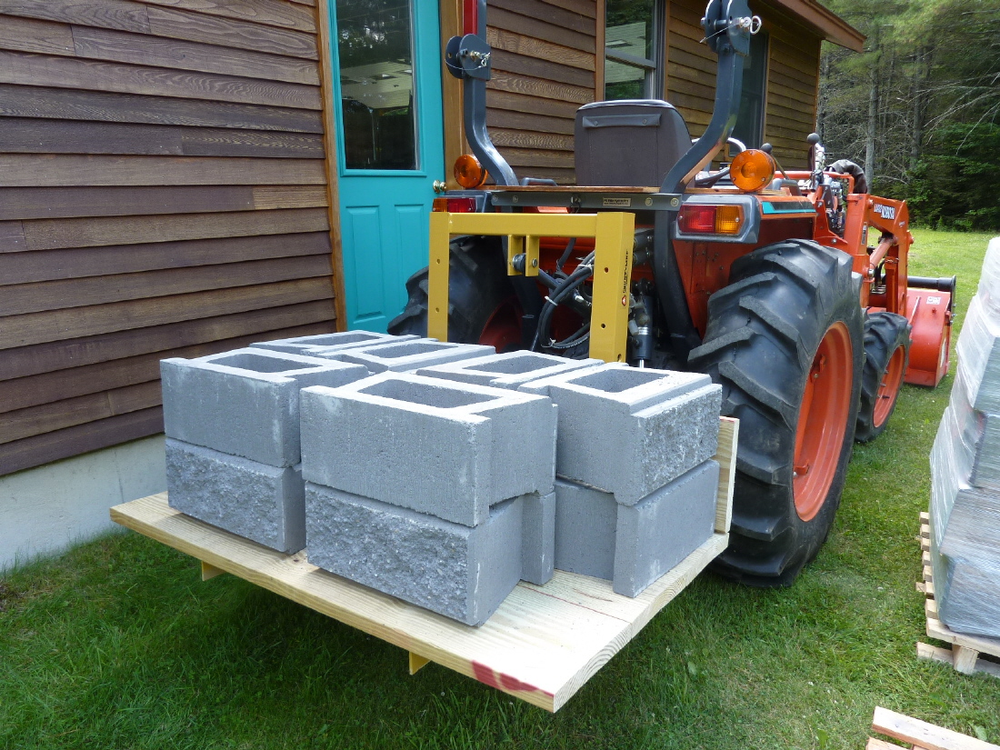

TSC carry-all with 12 bloks at 80 lbs a piece or 1/3 cord hard wood. You can't go wrong.

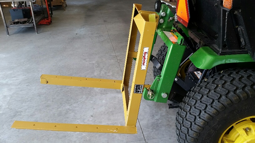

King Kutter makes a carry-all that is i-Match compatible. I have one.
