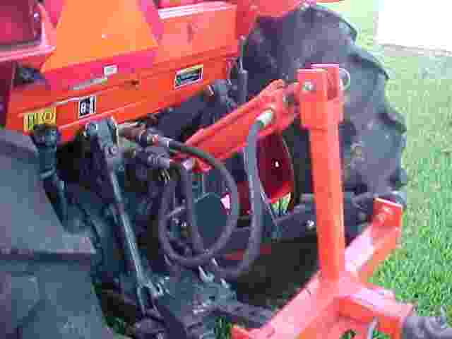

A picture of a hydraulic top link. If someone really wants to build one I can take it off and take close up pictures of the ends.

Here is a pic. To make the top link:
1. Get a new cylinder. I think mine might be 3" bore x 8" stroke. I have a bigger tractor M6800 so you might want a 2 1/2 or 2" cylinder.
2. Unscrew and discard the end off the cylinder rod. Take the cylinder to a good nut and bolt house and order a nut to fit the rod. Weld a 7/8" (cat I) spherical rod end to the nut. Weld the nut to the rod. If you don't weld it, it will loosen.
3. Remove the pin from the cylinder end. Fit (cut with a torch and drill) a piece of thick plate such that when this pin is reinstalled, the plate will only have slight clearance between the plate and the contact points on the cylinder. The force on the cylinder ends must be exactly in line with the centerline of the cylinder bore, so you don't want the plate to flop up and down. I cut a plywood pattern such that with a hole in the pattern that fits the pin, It just touched the cylinder end when the pin is installed. Transfer the pattern shape to the plate.
4. Weld another rod end to the adapter plate.
5. Once you are happy with the rod movement compared to the remote lever movement, mark the hose ends and coupler ends with colored tie wraps. Mine are red and blue. When I p[lug in my hoses color coded, the cylinder always works the same.
6. With hydraulic top link installed, lift the attachment to highest and lowest position and with cylinder in and out to make sure at no place does the cylinder or rod end hit the implement frame. I found today that mine does, so it will need a grinder adjustment.
Good luck and enjoy

Wrong pic. Try this one:

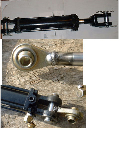

Here's a picture of mine. I unscrewed the rod end then welded the ball to it. Couldn't take the other end off, so i just welded the ball to the pin, then welded the pin to the cylinder to prevent it from flopping around. I ran my hoses to the FEL valve that came with my tractor ( I didn't get an FEL - yeah, I know, how stupid could I get? /w3tcompact/icons/laugh.gif). Because I didn't need to buy the valve, this set-up ran me a little under $150.
This works really well. My only problem was the weld was good enough, so I have to have my neighbor weld it... he's practically a pro at welding.

Do both ends need to be a swivel? I've seen some commercially made hydraulic top links that have one end a standard pin through a clevis and the other end a swivel ball. I'm thinking of making mine that way.
   / Carryall & 3pt geometry question #20
Both ends need to swivel, because when you tilt the attachment you get some strange angles out of your top link in both the hortizonal and verticle planes. Also be sure that the tractor end has sufficeint clearance of the cylinder from the top link attachment point. I missed this measurement and ripped the ball out of its socket when I attempted a strange tilt of box blade when I also had the tilt at an extreme angle. T-N-T is greatest thing since FEL.
