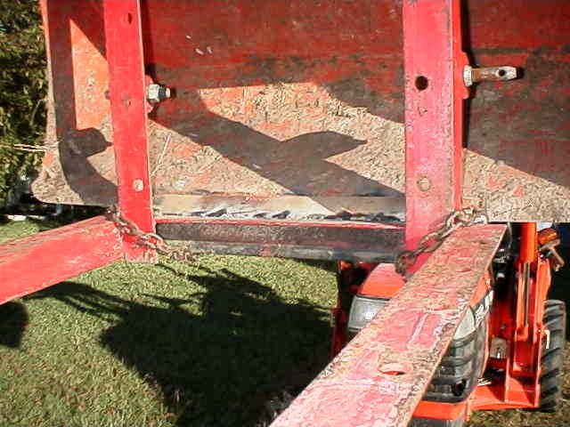

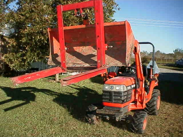

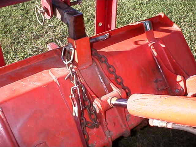

OK. As I posted before the flood hit Texas, I have attached my carry all to my FEL to use as forks.
I welded an attachment slot to the back of the carry all and made an L out of 2" square pipe to fit my 2" receiver on the back of my FEL, and used 1/4 "chain and a boomer to keep the bottom tight against the bucket.
A picture is worth a thousand words, so here are 5 shots of the method I used to attach the carry all to my FEL.
   / CarryAll as Forks #13
Pictiure #2
   / CarryAll as Forks #14
picture #3
