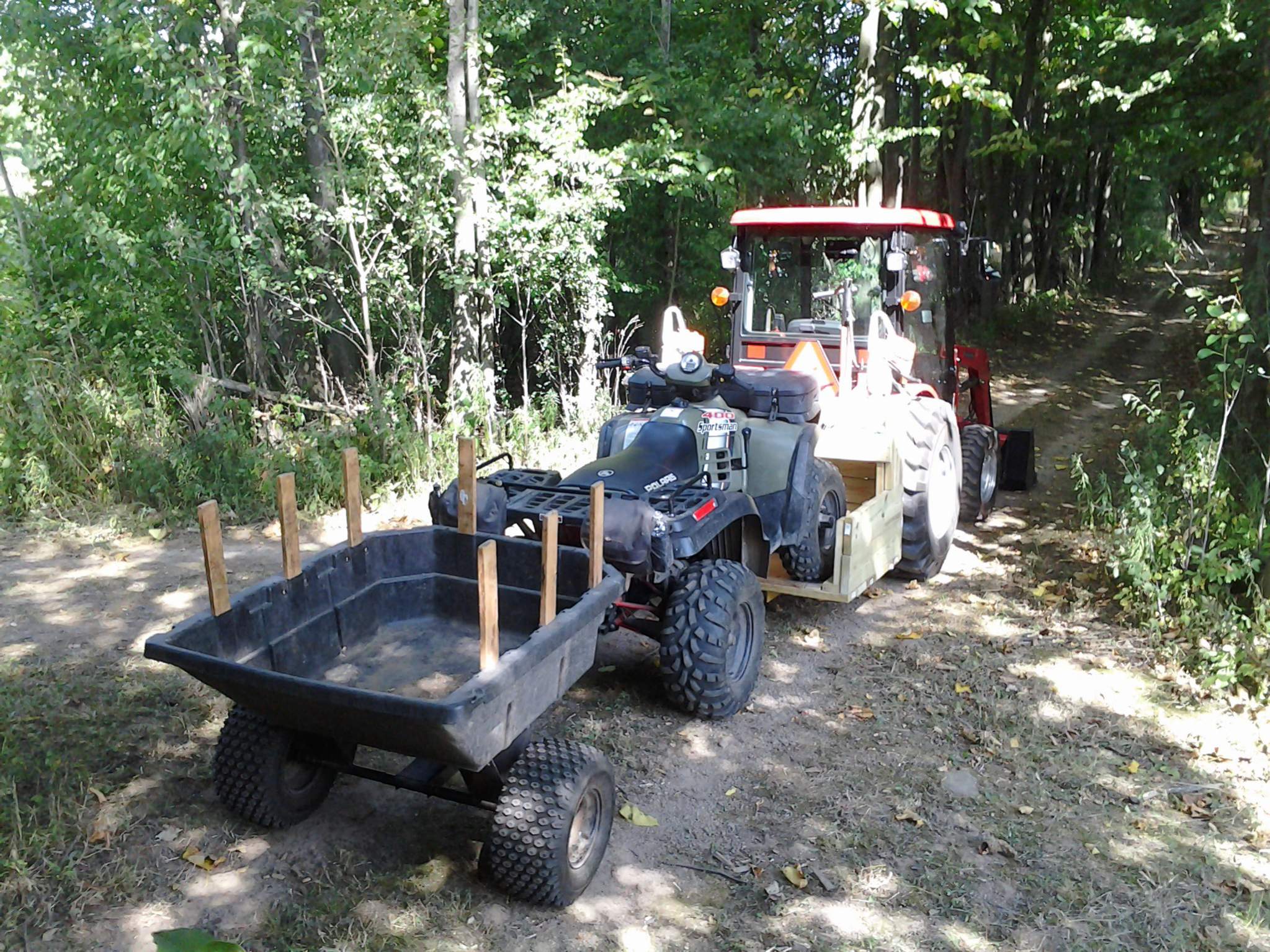

Carry all's come in handy. Sometimes I need the four wheeler out in the woods, so I can get to spots I can't get with the tractor. It's only about 3/10 of a mile walk, but I'm to lazy for that. 0826121506.jpg
I like the carryall for the carryall, I may have to steel it too.
