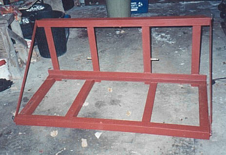

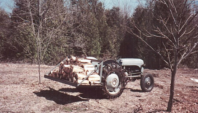

See attached - this carryall turned out pretty well but is on the heavy side. I figure there are 200 pounds of steel and maybe 60 pounds of oak (inch and a quarter), so it's a bit hard to wiggle around when attaching to the three point.
It's been great for hauling rocks to the rock pile, and other odd jobs. Makes the steering nice and light too.

Jim, I think that is just what I am looking for - especially for lighter weight material like wood (as opposed to rock). Would that be a 9N you're sportin' ?

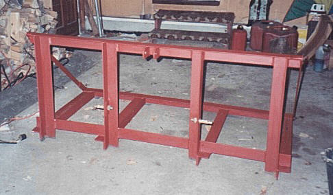

Nice carryall ! How about some closer pics and some dimensions ? I need to make one myself .

The tractor is a '52 Ferguson TEA20. Up here we got the British made ones made by the Standard Motor Company (later Triumph), instead of the TO20 with the Continental engine, but they look the same.
Anyway, dimensions. It's all 3 x 3 x 1/4" angle iron, because my brother gave it to me. If I were doing it again I would use 2 x 3" to save weight (if I could get it for the same price) but then I would have to scratch my head to figure out which way to put them. It would be worth it though - it would save around 40 pounds.
There are three pieces 6' long, 4 pieces 3' long, and four pieces 30" long, for a total of forty feet. The base would be 6' x 3' but the way I made it I lost 3" at the inside corner so it's 6' x 33". The 30" pieces are for the vertical part. The two middle vertical ones are spaced 26 1/2" apart but that was a bit much - there is about a 1/2" shoulder on each pin, so the lift arms are about 27" apart. It doesn't sway much, but it's harder to hook up.
For the floorboards, I sorted through rough cut oak. Where the 6' long 1/4" thick angle iron is on top of the four "floor joists", I used 1"x3" boards, and between them I used 1 1/4", so they all would end up flush. Boy that's hard to explain. Anyway they are just bolted down with carriage bolts.

Jim - 'been busy at work for the last few days. Saw your pictures but no time to write much. The carryall looks nice. I was thinking about messing with your design so the lower (rear) angle was turned up, and then a sheet of 3/4" plywood, or a few planks would slip in and maybe not have to be bolted down. In fact, the reason I got thinking about it was that I'd like to add sides, and was thinking about making them out of plywood.
You were talking about weight - do you think you could go as small as 2" angle? It looks as though with all the bracing, that I could go smaller on at least the middle pieces. But 200lb doesn't seem all that heavy, especially if you are going to try to fill it with wood.
   / Carryall picture
I think if you had the diagonal braces on it that 2x2 would be fine, but this is my gut feel, not engineering. We made the diagonals removable in case I want to carry an awkward sized load, like sheets of drywall or plywood. In that case, the capacity depends on the strength of the inside corner, so there's where you really need to think about whether 2x2 will work.
I preferred not to use plywood for the floor because it is sitting outside, and also, I knew I'd be hard on it (tossing hundred pound rocks aboard) so wanted it tough.
200 pounds is OK but it's hard to move it to attach to the tractor, mostly because the edges of the 3x3 are what rest on the ground, so it digs in a bit.

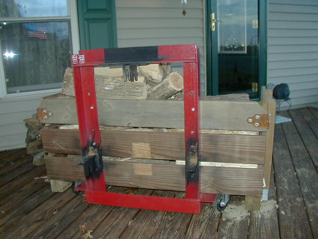

here's one i built with a carry all kit, i added the treated lumber. i use it to carry stuff, but mostly i use it for a wood box for the front porch in the winter. it has casters and a slotted attachment so i can just back up and drop it on the porch and then roll it where i want it. comes in handy in the garage also with the wheels i can move things around.
   / Carryall picture #14
Nice carry all. You make me think about what I am trying to do with our wood. We have always stacked it on pallets about 6 feet behind the house, then brought it into the cellar in armloads. It kills the lawn every year. I got a couple rolling steel racks with the large wheels in the middle, and one caster on each end, that a local retailer sold when they closed. They hold about a sixth-cord each, and we were going to use them to roll out to the wood pile. Now that we have a tractor, we have decided to keep the bulk of the wood farther away, bringing it up as needed with the bucket and using the racks as intended. Now I think I will modify my plans to make my carry all more like a set of 3-pt forks, to carry the racks down back.
