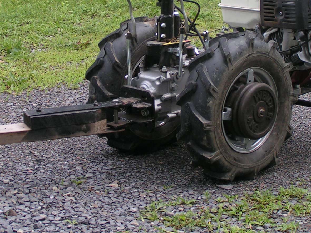

Here is a link to the Gravely two wheel tractor pull behind cart.
They key is the linkage between the tractor and the cart.
Gravely uses a hitch ball on the tractor with a split coupler that fits into a pipe on the trailer tongue, and then a pin locks the split coupler in place in the pipe. Some folks have fabricated other linkages or you can find these parts on ebait. Been a while since I've looked, but I would guess they would run $30-40ish.
http://www.oldgravelys.net/pdf/Cart_2_Wheel_Tractor_Op_Manual_0879.pdf
Sometimes you see Gravely riding seats sell pretty cheaply in your local sales papers or on line ads, and one of those could be adapted to a cart. I think one of mine just has a regular hitch ball on it so you can pull a cart behind it.

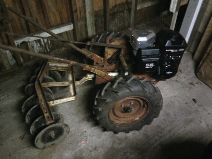

Here is the engine mounted and the disk on it. I bought the engine (5.5hp 6:1 gear reduction Briggs) from Tractor supply online. It was 280 shipped to my door. It was about 200 cheaper then anywhere else I found. It does a good job. I will be blasting it and painting it next weekend. also am going to order new tires. It has a guard that will go back on it for the belts.
Thanks for the PDF above. I am probly going to do something similar.

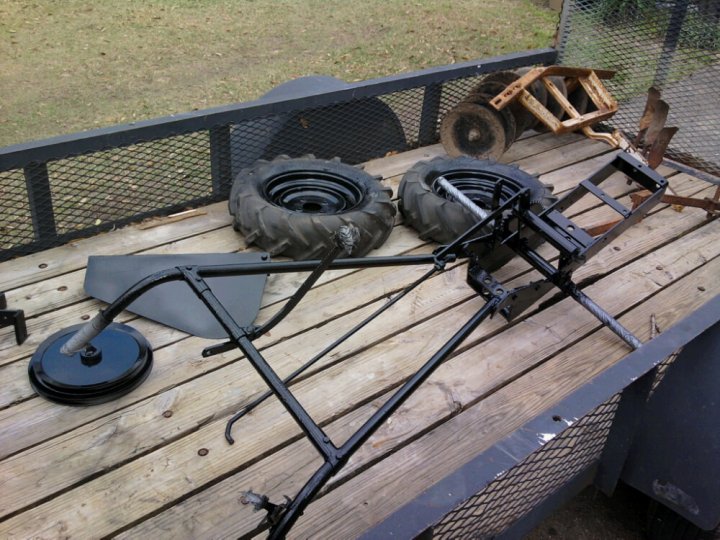

I sand blasted everything this past weekend and will assemble hopefully this weekend.

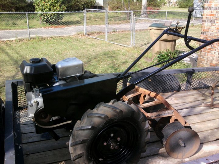

Finally got around to putting it together today after church. It was originally red but I had some black on hand after I sand blasted it.

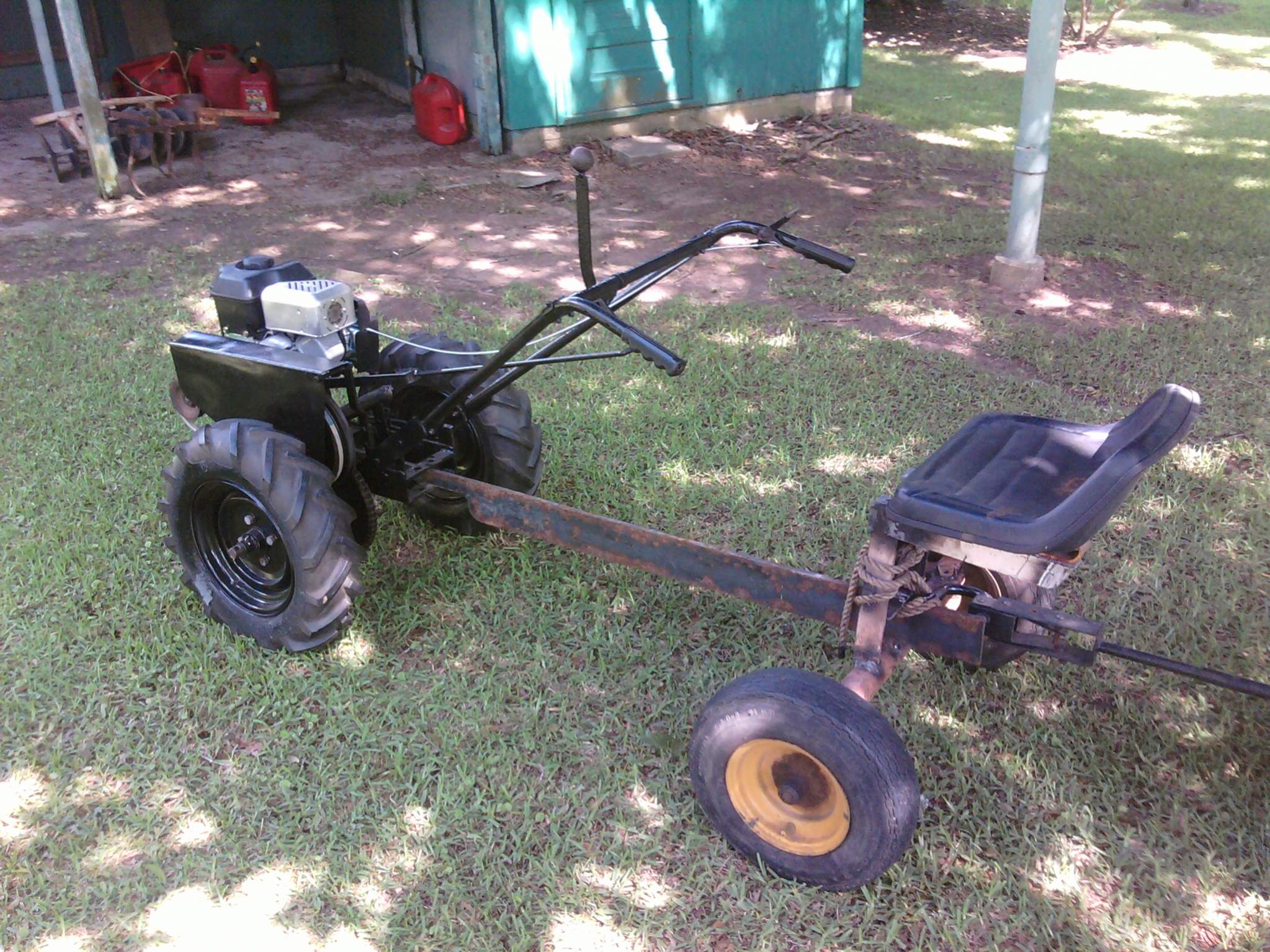

I kept the Edko and I am glad I did. I built a sulky for it. It holds me fine and I will be putting a ball on it to pull my utility trailer. The turning radius now is about 20'. I have an idea about putting a hinge on it just after the Flat bar start being full width. With it like this I will be able to turn a whole lot better. Any thoughts on this idea? Here is a Picture. I took this right after building it. It needs some grinding and sandblasting and paint.
