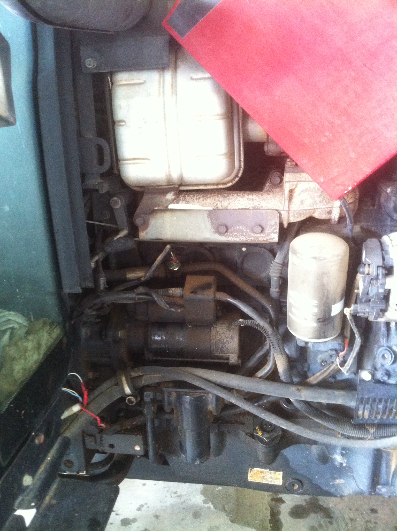

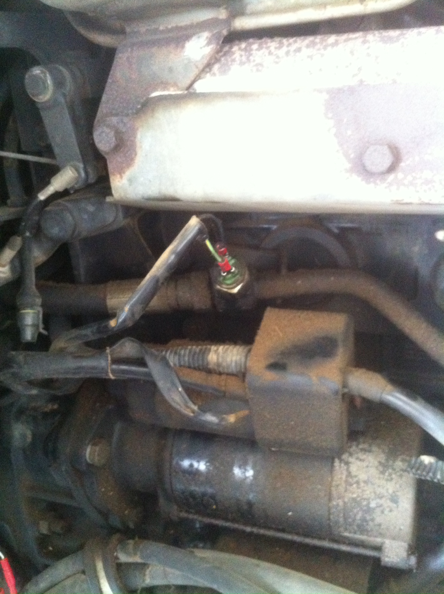

Just an update, the filters were delivered and he said that the main spin on hydraulic filter and the steel mesh prefilter were both changed, but no change, so he has ordered a replacement for the pressure sensor. I suppose it just one step at a time.
   / Case 1100u Emergency stop warning light.
#12
He sent me a picture of the sensor in place as apparently the parts supplier would not order a replacement until they had a picture of the original and an overview of its position on the engine. Doesn't give me a lot of faith in the parts supplier he is dealing with but at least he is moving forward.

   / Case 1100u Emergency stop warning light. #13
Wonder if he could jumper the wires together on that sensor? Looks like a simple pressure switch. He could also disconnect the switch and put an ohm meter across the switch terminals to see if the switch is closing under pressure. He might also be able to remove the switch and replace it with a pressure gauge to see what kind of pressure is there.

#16
Sorry for the slow reply, I got a week of night shifts offered, and that is just cruising round like a security guard no workshop time, so I have been out of contact.
The new sensor arrived and he fitted it in less than 2 minutes. The 1100u is now working normally .
Thankyou all very much for your advice.
