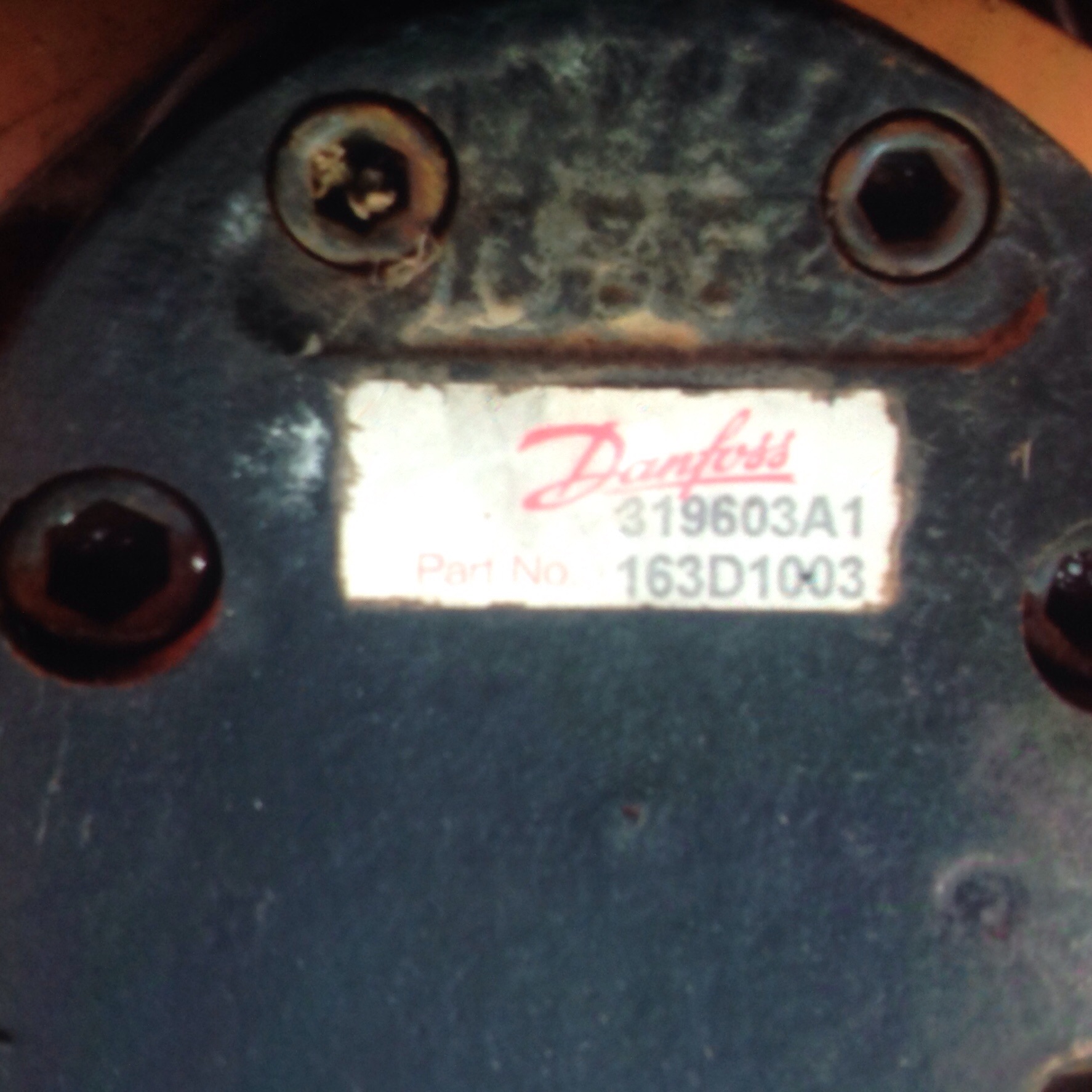

I have a case 1845c skid steer. I want to know what size pump it has. They came standard with a 16 gpm pump but I know there was an option to put a 30 gpm pump on. I called a case dealer and basically cause the computer didn' tell him pump sizes he didn't look into it any further. The pump is made by danfoss. So I talked to a danfoss dealer. The guy told me there are numbers on the side of the pump that he needs, so he can tell me a size. There are no numbers on the side. Hopefully someone has the same pump and knows the gpms. I'll post a picture of the tag on the pump. image.jpg

Those weren't the numbers he needed?

I guess not. On case's part diagrams I can find the pump but they give no gpm. It makes no sense why it is so hard to figure out something so simple.

My guess is those numbers are OEM specific for Case and as such they are not allowed to provide any details to anyone other than Case.
A flow meter in the line would be a simple check. Is there a hydraulic house in your area that could run a quick check for you?

Standard pump is a 16 GPM pump with a 30 GPM pump option.
Measure the flow into a 5 gal bucket.
16 GPM
1 GAL = 3.75 sec
10 sec of flow = 1.6 gal
You say it is a Danfoss pump. May be a after market replacement pump.
