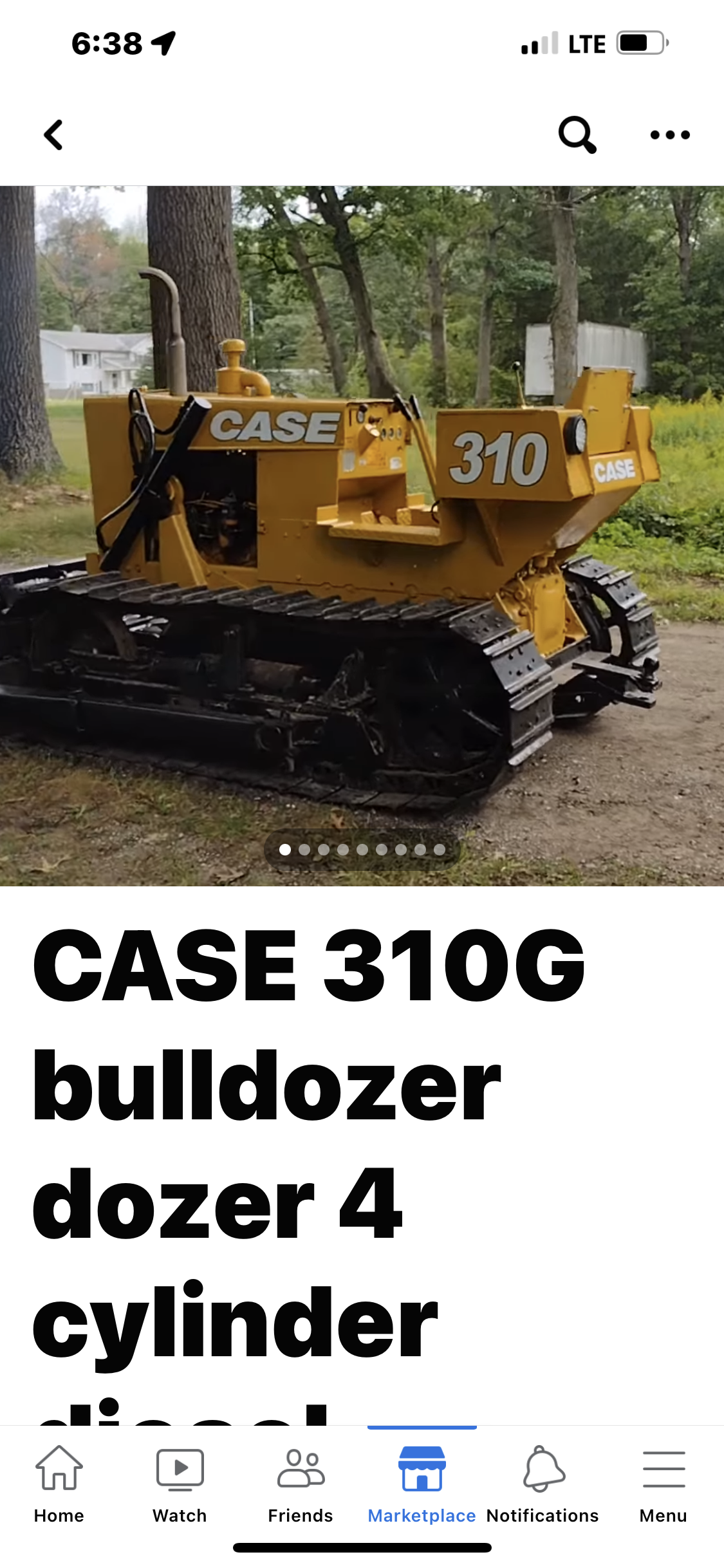

I have a case 310 G dozer looking for a manual transmission can’t find year it was built serial number 3033245 any help would be appreciated

Sorry I’m new to this am actually looking for the complete shifting unit on side of transmission not transmission

Your 310G falls in the 1967-1969 category:
310G - CASE CRAWLER TRACTOR (S/N 3032301 TO 3039619) (01/67 - 12/69)​
Is it the shift mechanism that you are looking for?

Yes that is the shifting mechanism my shifting lever will not stay in slides I’ve tried new washer an clip with no luck slides look good think it could be the detent on second an third gear do you know if I have to split dozer to get the shifting unit off transmission thank for your response

No idea. I don’t think I’ve ever seen a Case 310G. Do you have room on the side of the transmission?

It doesn’t have much room frame is about 4” away from shifter maybe

I have my 310-G TOTALLY apart to put a reverse idler shaft in it. NO shafts left on planet earth and 310's ate them for lunch! SO now I gotta make a substitute shaft somehow.
In answer to your question yes the shifter comes out the side BUT to do much on the transmission you have to totally take the tractor apart just to reach the internals!
NOT a good model to tangle with as I found out too late!!!!!

Try a machinest they have made parts for all my equipment in the past there going to make me a detent rod rod for my shifter on my 310 G as soon as i get it apart your rite have to split dozer apart for a 20$ part

I tried every parts yard and every dealer on the internet and there are NO reverse idler shafts left on planet earth cause the 310's ate all of them a long time ago! LOL !!
This was a design flaw and Case went ahead with it anyway and it will never hold! The 2 tiny roller bearings inside the gear go out every time you turn around!!
The bearings were WAY too light to hold the abuse of shifting into reverse.
