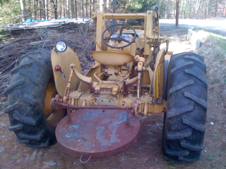

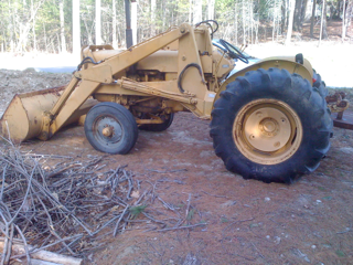

This is my 1958 Case 310B. I bought the tractor a couple years ago, it ran very well at the time. Then one day it started to knock. Turned out to be a broken crankshaft. So I decided to tare it down and do a major rebuild. This thread will chronicle the taredown and rebuild. Stay with me. I'm going to do this whole thing from my iPhone.

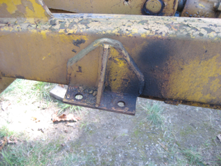

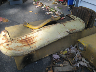

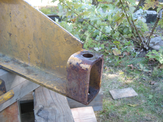

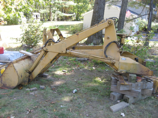

I started by removing the tin to make room for the loader removal. The loader is only held on by 6 bolts Four bolts on the front (2 per side) and 2 large bolts on the rear. The hydraulic pump is just 2 bolts and it slides right out.

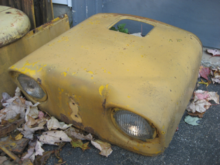

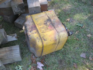

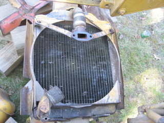

Then I removed the air cleaner, radiator and fuel tank.

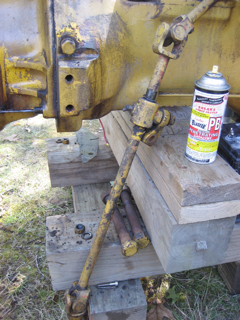

Then I blocked up the tractor under the torque tube, and removed the steering shaft from the steering gear.

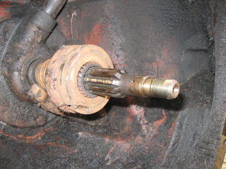

Remove the Hyd. Pump shaft and coupler from the engine. The pump will be removed when the loader is taken off. The pump will stay with the loader. My shaft was frozen so I needed to remove both. The shaft should pull right out, in which case you can leave the coupler on the motor.

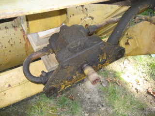

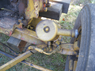

Remove steering pump and tie it to the front end.

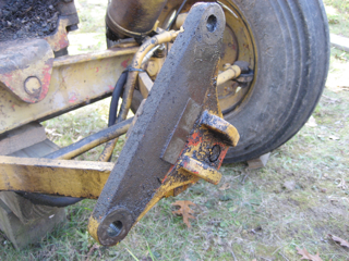

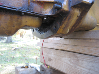

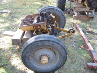

Remove the lower wishbone from the bell housing, then the bolts between the front steering gear housing and the engine. At this point the front end can be rolled away from the tractor.
/ Case 310B taredown/rebuild
#9
Here is the Case with the front end removed.
More to come.

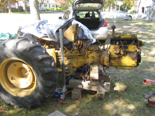

#12

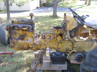

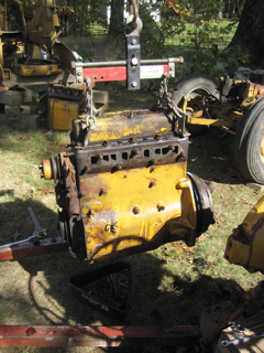

Remove any remaining linkage, bolt up an engine hoist and pull the engine mounting bolts. The engine will slide right out.

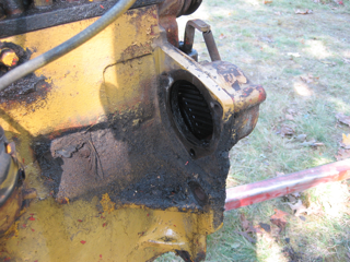

#13

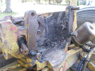

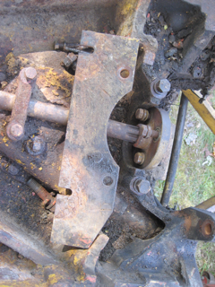

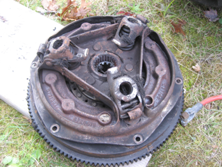

The inside of my bell-housing was a mess. It looks like an animal got in here at some point and had a very bad day! My pressure plate and and clutch looked just as bad. My throw-out bearing is junk and will need to be replaced.
#14

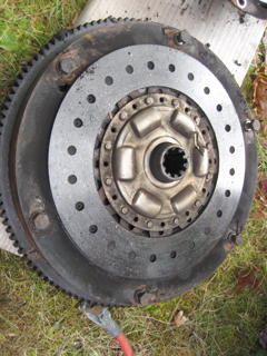

I cleaned the parts up a little to get a better look at the condition of the components. The ring gear on the flywheel is a little beat up and the clutch disk is pretty worn.

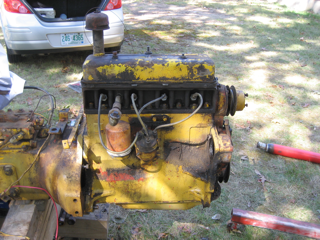

#15

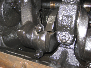

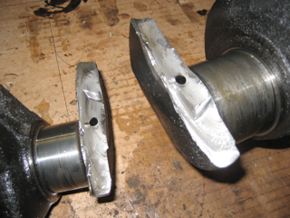

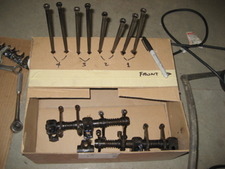

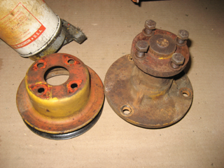

Then it was time to start the engine tare down. The pulleys, pumps, valve train and head came off, the piston tops looked pretty good. Then the pan came off and there it was!! The broken crankshaft. Broken in two. After a closer look I found that someone had replaced the bearings and put the caps back in the wrong locations and some were backwards.
NOT GOOD!!!

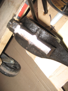

The center journal was junk. The bearing had spun and the broken crank had done a bunch of damage. Time to talk to my engine shop.

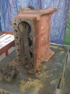

So I spoke to Jim Driscoll at Lawrence Crankshaft in Massachusetts, about 20 min. from home. This shop works on everything, from Cat's, to Detroit's, Chevy, Ford, you name it. He builds the pro stock race engines for my neighbor, any way.... I brought the Case 148 engine to him to take a look. We ended up shaving the main caps down and line boring the block. Unfortunately the damage to the center journal was too bad for this repair. I had one more option, Jim can pin a shim into the journal and then line bore it again. He has done this for some big diesel engines and he has never had a problem, but it's a $500 repair.
So I decided to look for a used engine for parts. I ended up getting lucky, I found a complete engine, same G1000 block for $500 bucks. Thanks google! I had picked up a new crank, cam, and rebuild kit so away we go. This is the replacement engine that was pulled down at the engine shop.

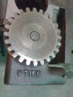

The next issue I ran into is the Case 148 oil pump. The pump was worn. I looked for replacements but a new pump is over $600 bucks! That's not happening!! So Jim at Lawrence Crankshaft tried a rebuild. He sleeved the housing and made a new bushing, the repair worked great for less than half the cost of a new one.
