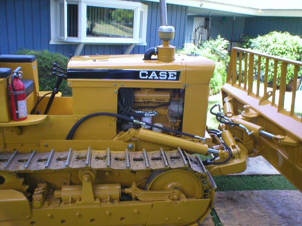

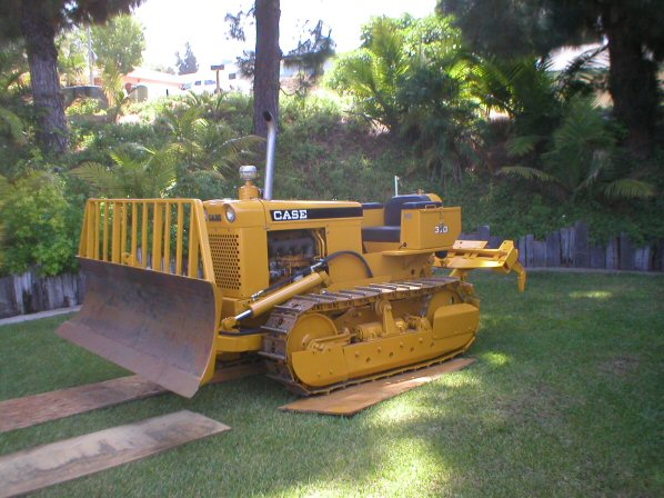

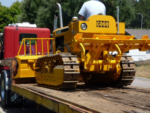

Here is a 6 way version on my 310. Case actually used a couple different 6 way blades on their machines.;)

Nice find. The c is newer than the straight numbers. We have a straight 450 with a six way blade. Needs some work done to tighten blade for grade work but is still nice.
A six way blade will have 2 levers. A joy stick for up/down and tilt. Then a separate one for the angle. It will also have a c frame instead of push bars. And 3 cylinders right behind blade.
