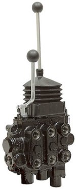

OK here's an update. I found the missing poppet. It had gone sideways and lodged itself in the rear of the block in the first port relief causing the above mentioned stalling/blockage. So I'm back to the original problem of the drop.
I lifted the bucket up about a foot and stuck it on a chock then disconnected the hoses from port A&B and plugged them. On removing the chock the bucket stayed solidly in position. So that rules out the cylinders and brings us back to the spool.
On taking the control valve around to a few places today, I'm looking at $2500 to replace it with an aftermarket sectional valve. The big expense seems to be in adding the four port reliefs and the detent float. I could get a monoblock for about half that but they don't come with port relief.
So question: How essential would you rate port relief? (I understand its role is to save the cylinders in the case of a shock to that circuit while the spool is in neutral. I'm just using it every few weeks to push dirt around on our property for a motocross track.)
While I am reasonably certain that it is a worn spool, I will follow up the possibility of the port relief on that spool not sealing properly.
If port relief is not essential, would this Prince unit from Surplus Centre do the trick (Surplus Center - 3 SPOOL 25 GPM JOYSTICK LOADER VALVE W/GRAPPLE
Still $600 plus adapters to get it here but that's a fair saving on what is available in Australia.
I'm taking a drive out to Toowoomba to go through a few tractor/rural wrecking yards tomorrow to see what might be available.

Yes but I can't see any port relief on the Prince valve (just main relief). Is that going to be a problem?
   / Case 350 - hydraulics drop from full height in less than 1 minute
#28

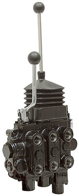

I'm leaning toward three levers instead of a joystick+lever.
See any problems with me using this instead of the joystick one?
Surplus Center - 3 SPOOL 25 GPM PRINCE RD532GCCGAA5A4B1 OC VALVE
Still has detent float on first
25gpm, 2000psi (main relief 1500psi).
Is it the same valve block as the joystick?
Are the ports the same on both? The joystick says SAE 12 & 10 but the three lever says NPT 3/4" & 1/2"
Is there anything I'm missing?
Pros and cons of Joystick vs levers?

I WON!!!
I pulled out all the check valves and port relief valves. One check valve had basically no orings left. Swapped the port relief valves around just in case it was the one on first spool that was leaking. Put it all back together and she's going up and down like a bewdy and staying up rock solid.
