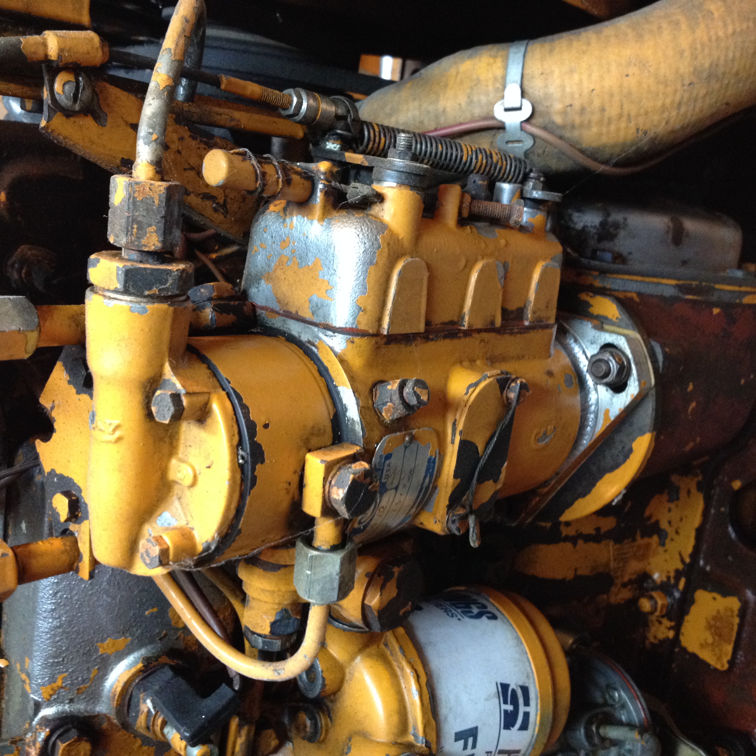

The tractor stopped running while brush hogging and has not been able to start since. I replaced the pump cover gasket because it was leaking and just wanted to double check the spring setting. I've taken the valve cover off and watched the rockers, everything seems to be OK. Wondering if it's possible to have jumped timing?

Hmm.. They can be a real sob to bleed.. have you loosened the bleed screw by the name plate,double screw.5/16??
It has an electric solenoid on it yes?? jump it straight off the battery w/ a wire..
Leave ALL THE LINES LOOSE AT the injectors & spin the engine until you get fuel & NO AIR & THEN tighten the lines..

No solenoid. Has the rotary CAV pump with manual shut off. I primed the pump at that bleeder screw and the one on the cover with the hand pump. Fuel came out with no air after just a few pumps then moved on to the lines. Seemed like it was going to run after a few of the attempts but always sputters out.

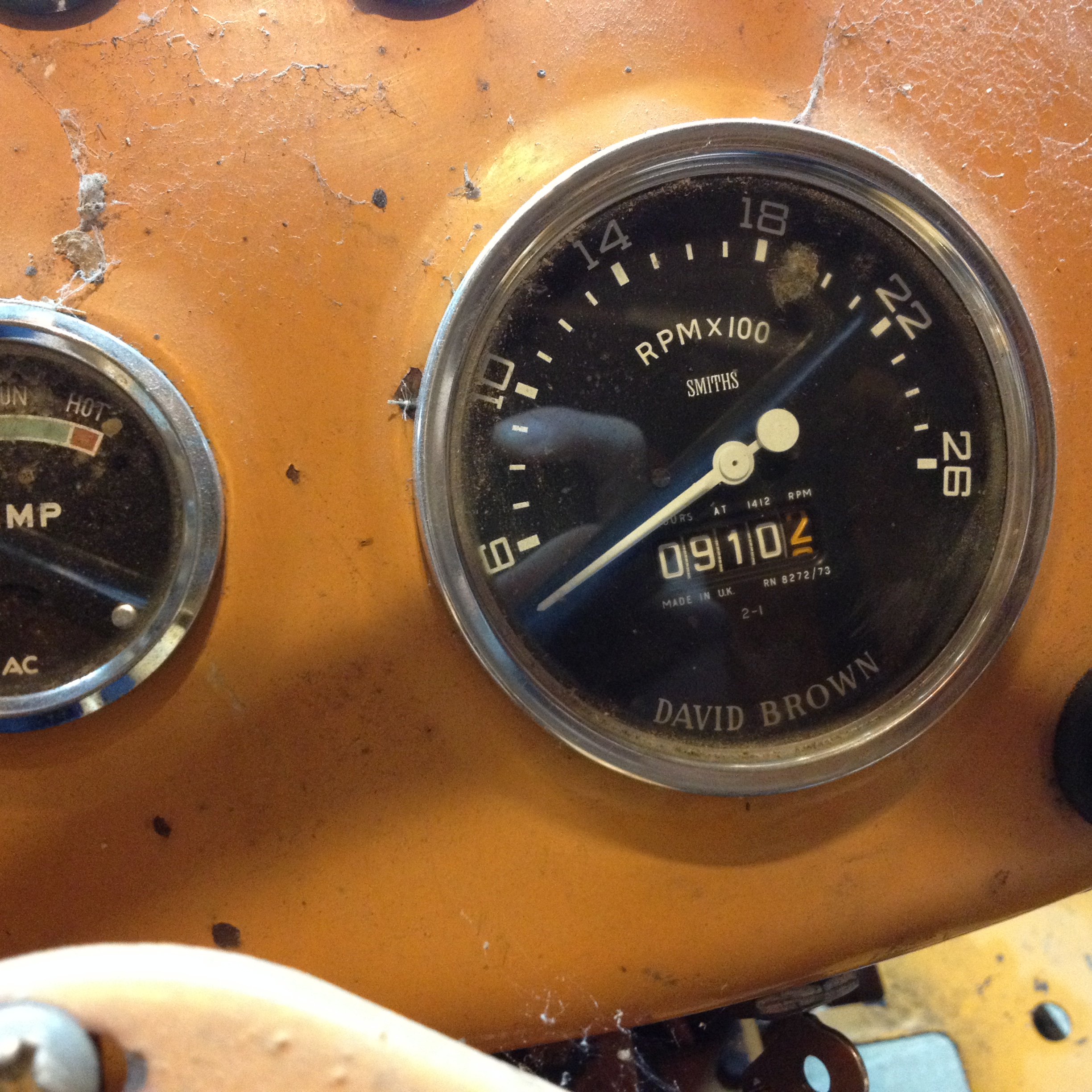

Shows only 910 hours so I guess I'll empty the tank and fill it with new diesel and try bleeding again. I'll update again soon.
