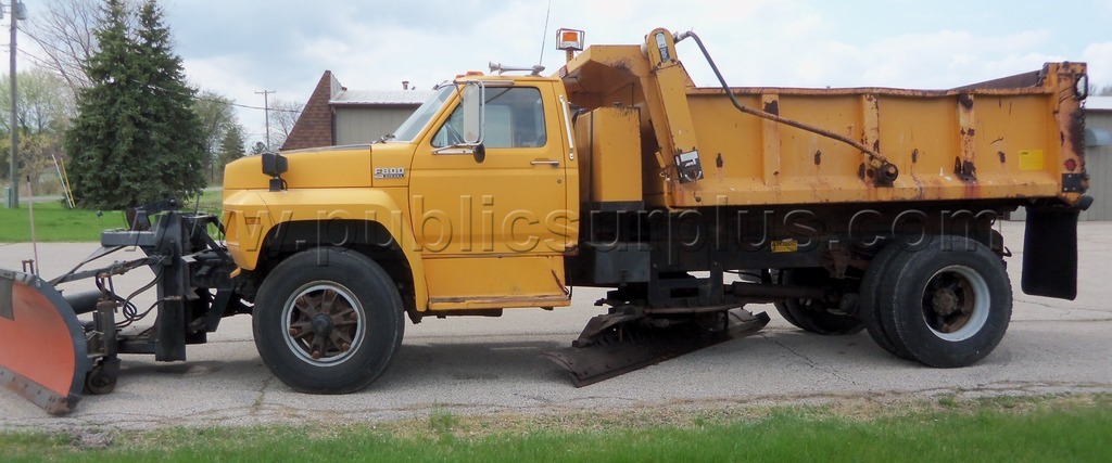

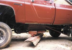

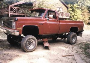

Belly blade on a dump truck? Would like to seem some pics. That's interesting.
You can do an image search, on your favorite search engine. There's tons of pics of them. Even found a pic, of one on a 4wd pickup. #2.jpgresize.jpg

100_1662.JPG Here you go
   / Case 480B with Loader, 3pth and center grader blade !!! #15
Wonder why the blade is tilted forward like that?
Thanks for posting the pics.
   / Case 480B with Loader, 3pth and center grader blade !!! #16
2 reasons. #1. If you're cutting hard material, either on a gravel road, asphalt, or ice, if it is worn, and has a sharp point at the leading edge, you tilt it ahead, and the sharp edge cuts better. Just like tilting a knife's edge. #2. Like pushing dirt with a dozer, tumbling, or rolling material pushes much easier, than a dead load against the blade. If you're needing to carry material a ways to fill in a low spot, you can set the blade pretty straight, tilt it ahead, and keep the material tumbling, keeping it from coming back over the top of the blade.
