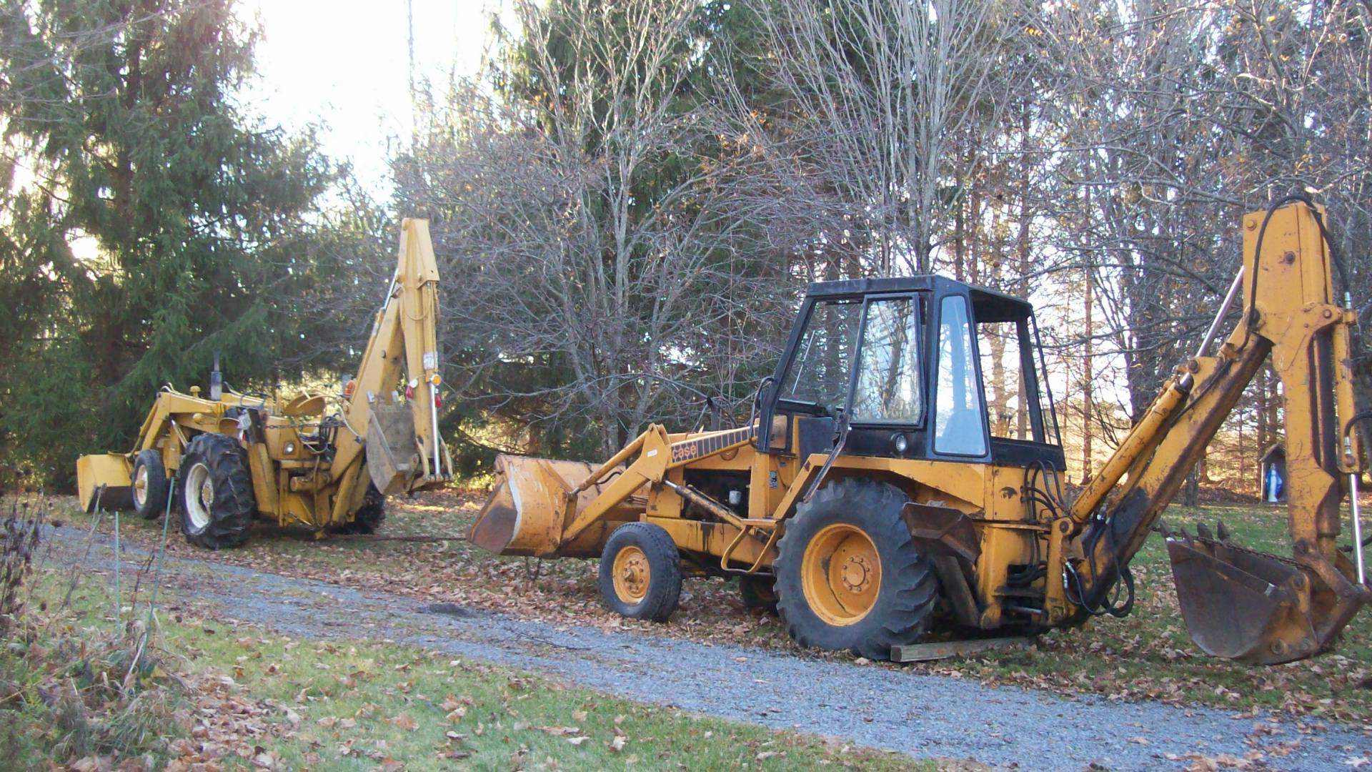

Other than the full glass cab, mine looks identical, even the extenda-hoe, except mine has floaters on the front. I wish they made the front glass tilt up too. I hate working, looking through glass. Reflections on the inside, seing what's behind you, instead of what you should be looking at, or going directly into the sun later in the evening.

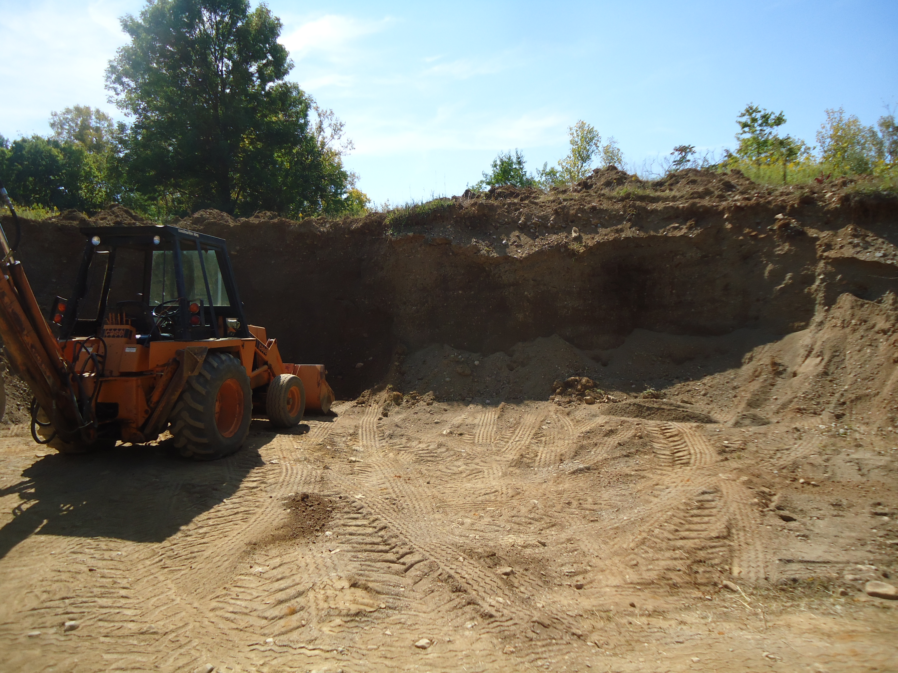

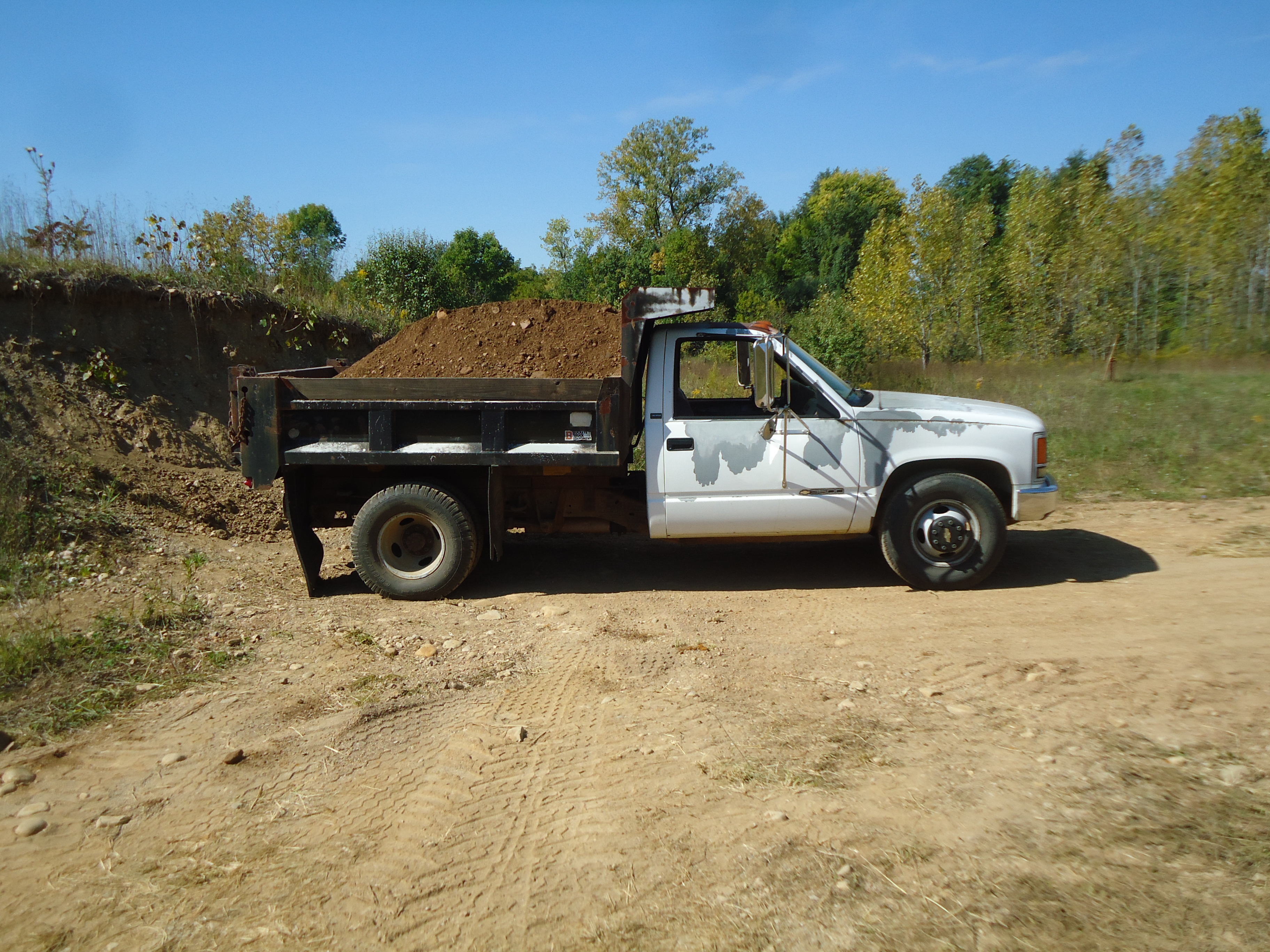

In Sept., I loaded 934 tons of bankrun gravel with mine, and hauled it on my little 1-ton dump for a new building pad. I don't use mine a lot, but, when I use it, I use it..!!
