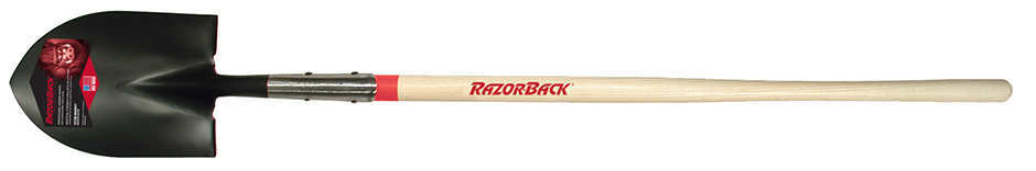

Case is a nice light hoe, with decent power. If I had my 'druthers,and a larger truck to pull the trailer with, a real nice Ford 550 4 stick would be my preference. Break out force has to be half again as much, and much faster cycle time too. But, the 480C is light enough to pull with my 1 Ton dump, so it works for me. Still way faster than using that #2 Razorback..!!

By the way what is a #2 Razorback?
