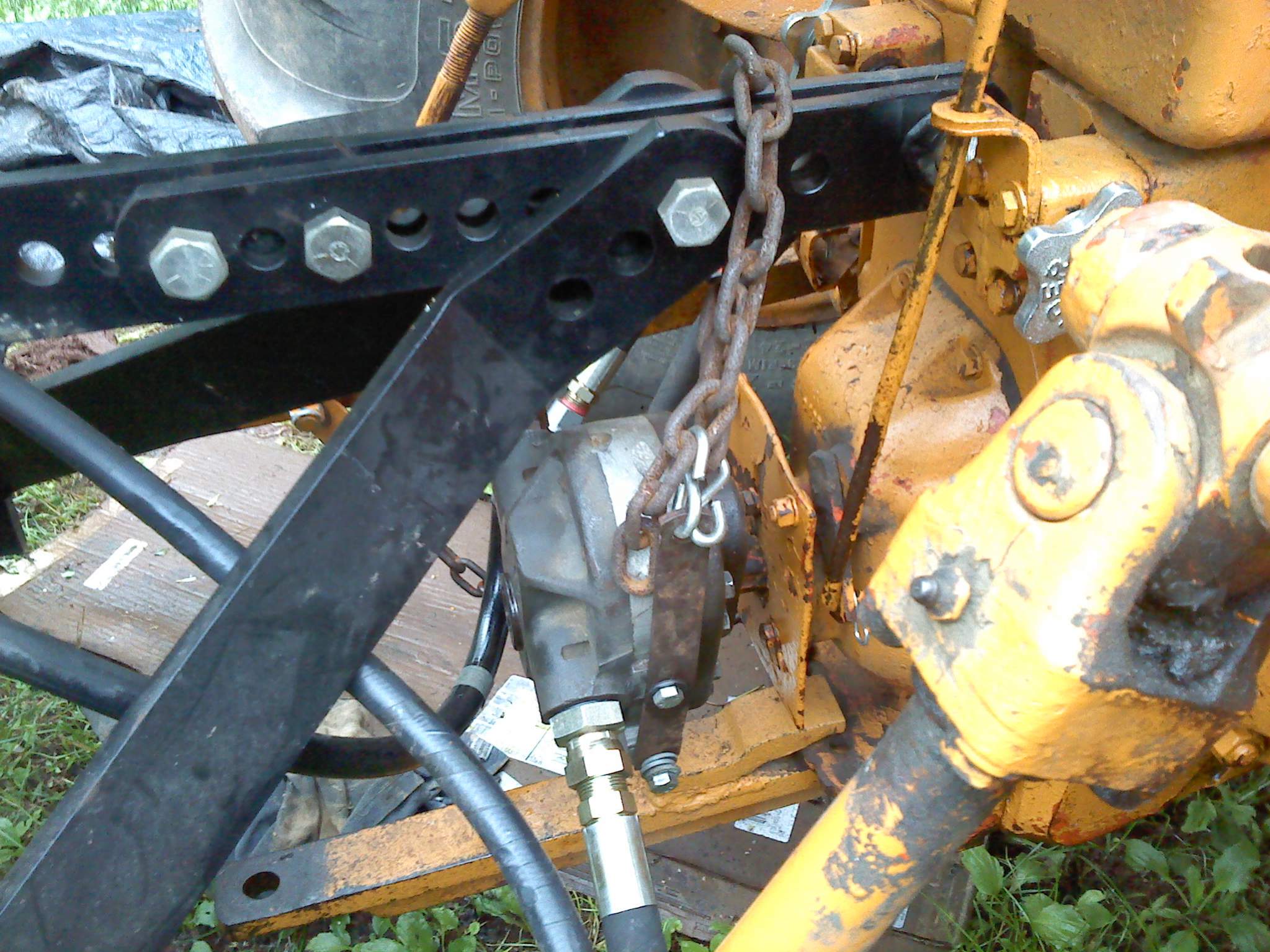

Thanks DJ that makes better sense, I'm still only getting 1000 psi at the rear hydro's. Looks like I will have to drain all the way down, replace the filters and start over.
I also got a Prince PTO pump ,do you think I can tee that into the loader returns to feed it ?

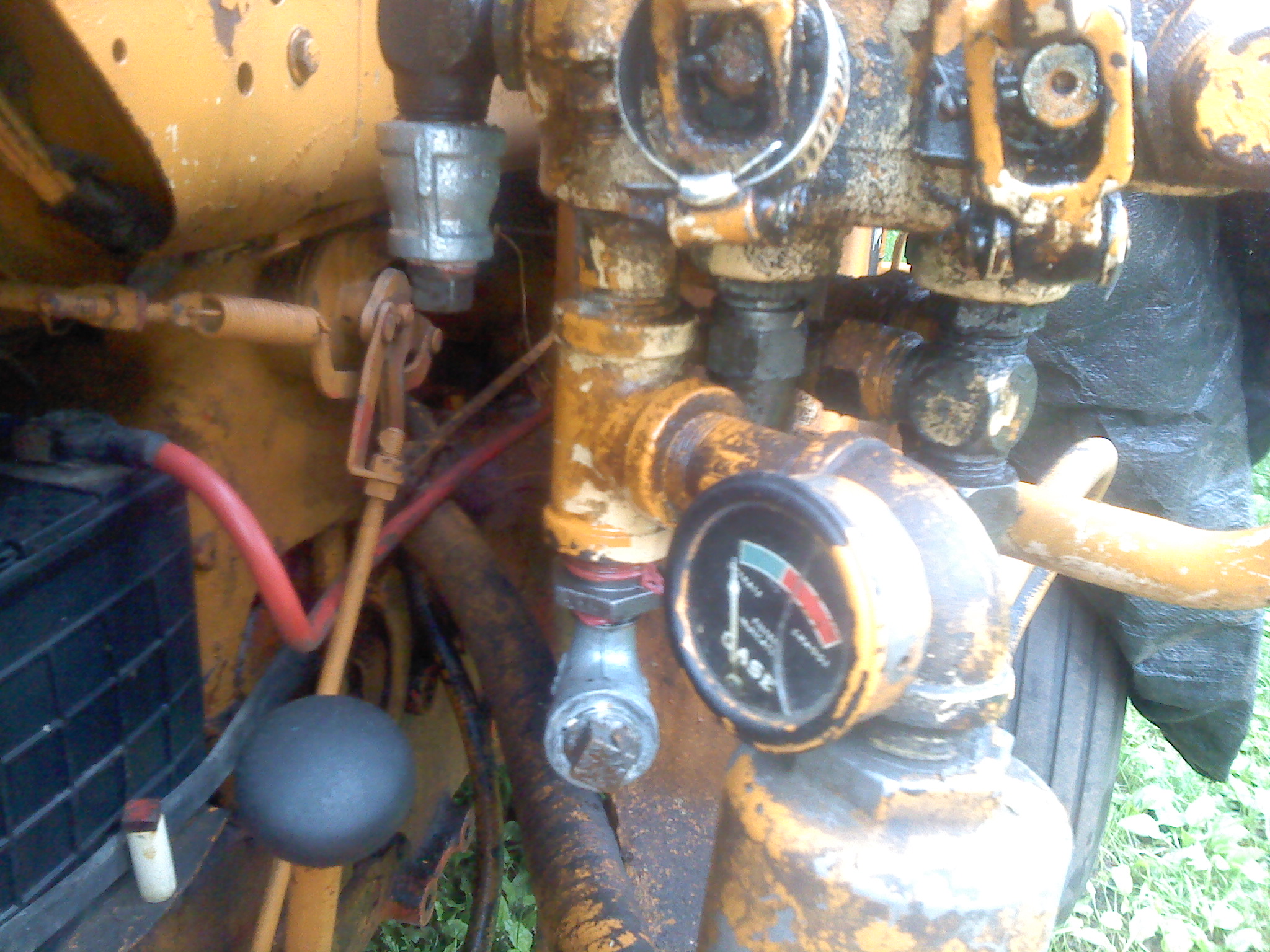

tractor tees.jpgYes I'v been there and thought I remember reading that the loader was 20 GPM @ around 2000 psi.
The hoe only needs 5-7 gpm @ 2000 psi and I don't really know how to plumb the two together that's why I thought of the PTO pump and teeing off of the lines at the valve. I have a pic of what I mean but don't know if it will work.
   / Case 530 3 point hydraulics question #7
Heck yes, I'd just plumb into those...!! A couple quick disconnects plumbed in, and you're in business..!! It maybe a little faster with the 20 gpm pump, but that's not a bad thing, once you learn to feather the controls.

Worked great! a little fast but I'll work on that. Here's what I did.
Thanks again

Good deal..!! I never thought to mention before, if it seems to be too fast, maybe in an out of the way place, reduce to 3/8" pipe on the pressure side reducing flow. I'm thinking a couple of reducer bushings, and a 1" nipple should do it.
But, once you get used to operating the hoe, and do more than one function, it may become too slow. 3 functions such as crowd, boom up, and curl will divide that volume produced to about 1/3. Just got to learn to feather those controls... And seat time is the best way to learn...
