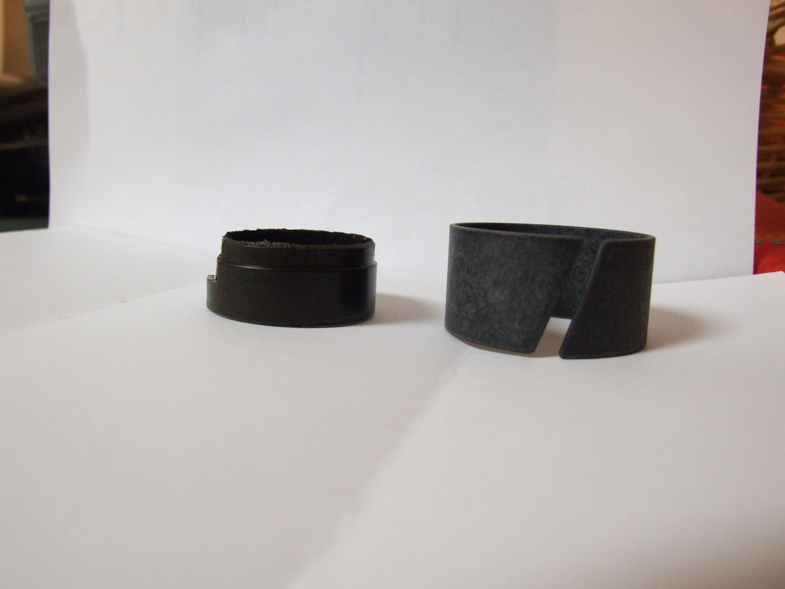

I am rebuilding a pair of bucket tilt cylinders on a Case 580C and have trouble understanding how that black plastic bushing fits.
I installed the gland seal and external dust seal without a problem but do not understand how the black ring fits.
Could someone that has done this recently offer some advice?

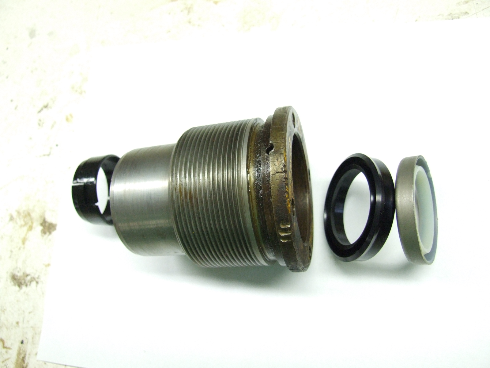

Scott, I'd like to bug you with a couple more questions and then I hope I'll be ready to "reassemble". 1) The way I understand what you have told me, the orientation of the inner and outer seals in attached photos are correct. Is that right? 2) Look closely at the inner seal shown in the photo. Did yours have a lip on the outside edge like the one shown? I kind of thought it would be flat like the inside of the gland where it is to go. Thanks again for all your input. Tommy

Hi, I rebuilt mine on a 580 last month and got a lot of advice from helpful folks here. I've attached a photo showing the correct orientation of the part you are talking about as well as the outer wiper. The seal takes a little force to get it in place but all of a sudden things will start to happen and you'll smile. By the way, I tried heating the seal in boiling water to make it more pliable but that did not help. Start by using your finger(s) to try to get part of the seal in the grove. I then used an 8" piece of a 3/8" dowel to push (with effort) the seal around to snap into the grove. Hope this helps. Tommy

Bill, I re-read your post and realized I might have answered the wrong question. I rebuilt 8 cylinders on my 580 last month. So far, all of my cylinders used an internal wiper (see attached photo) like the one on the left. Some of the re-build kits I bought came with both types while others came with one type and some came with the other. I had to buy 3 additional wipers separately. If yours uses the type on the left, it should snap into the grove with the thin edge almost flush with the outer edge of the gland. After I finished, someone told me I could have cut the other type to where is would fit in the grove and it would have worked on the internal seal. I don't know if this will work or not; didn't try it. Tommy
