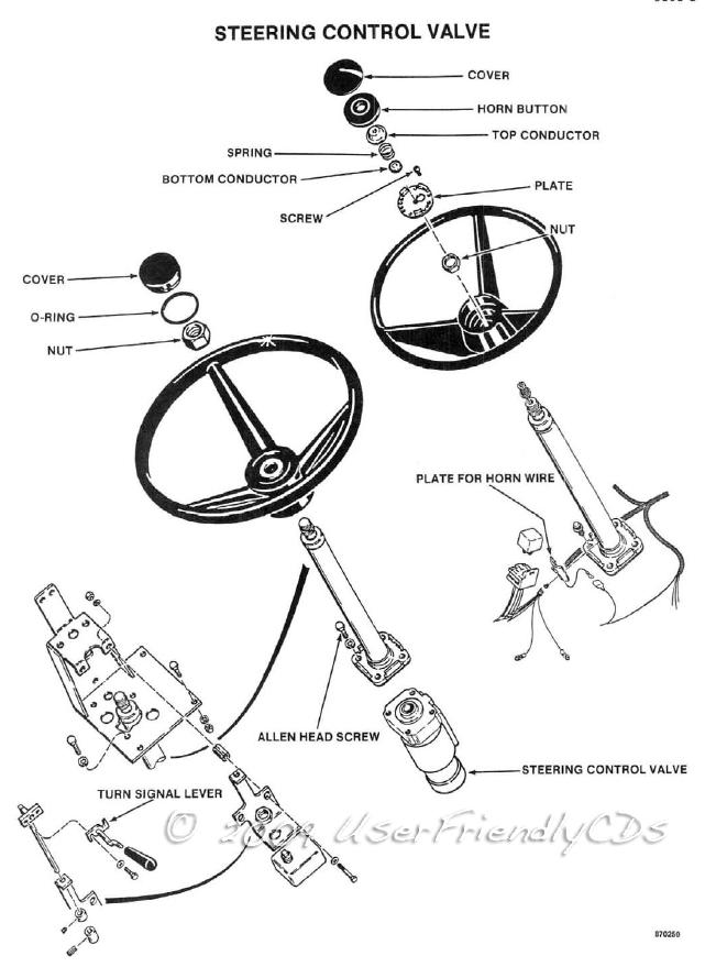

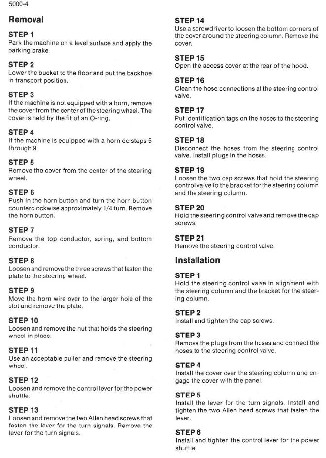

Jul 20, 2013 / Case 580 k backhoe #1 G GRJones New member Joined Jul 20, 2013 Messages 2 Location Townsville qld Tractor Case 580k backhoe There is an oil leak from the brakes. I want to change the brake slaves. How do I take off the steering wheel so I can get the dash panel off so I can get to them? Any assistance would b appreciated.
Jul 21, 2013 / Case 580 k backhoe #2 R ragkar Platinum Member Joined May 11, 2007 Messages 846 Location eastern PA-lower Poconos Tractor JD2320 w/R4 $21,100 w/7.16%off Try this Attachments case 580k steering.jpg 105.7 KB · Views: 238
Jul 21, 2013 / Case 580 k backhoe #3 R ragkar Platinum Member Joined May 11, 2007 Messages 846 Location eastern PA-lower Poconos Tractor JD2320 w/R4 $21,100 w/7.16%off A pictoral I hope!
Jul 21, 2013 / Case 580 k backhoe #4 R ragkar Platinum Member Joined May 11, 2007 Messages 846 Location eastern PA-lower Poconos Tractor JD2320 w/R4 $21,100 w/7.16%off Well,that didn't work. maybe this will. Attachments case 580k steering2.jpg 65.9 KB · Views: 510
