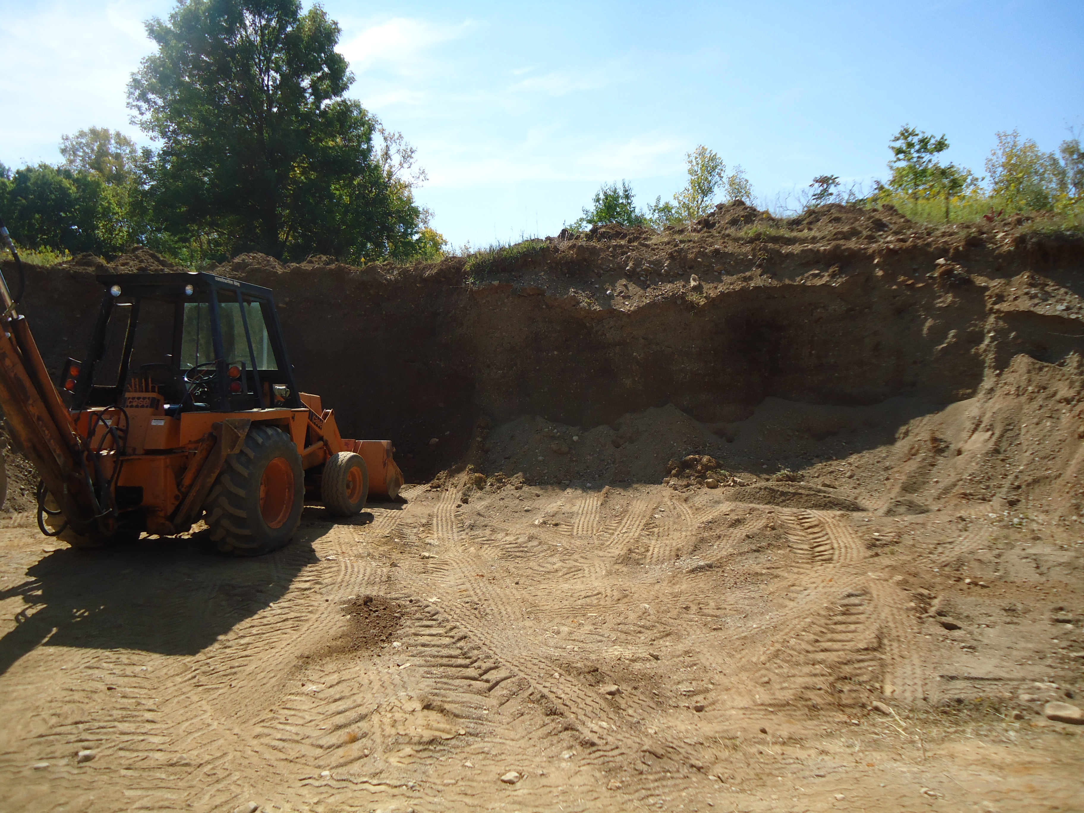

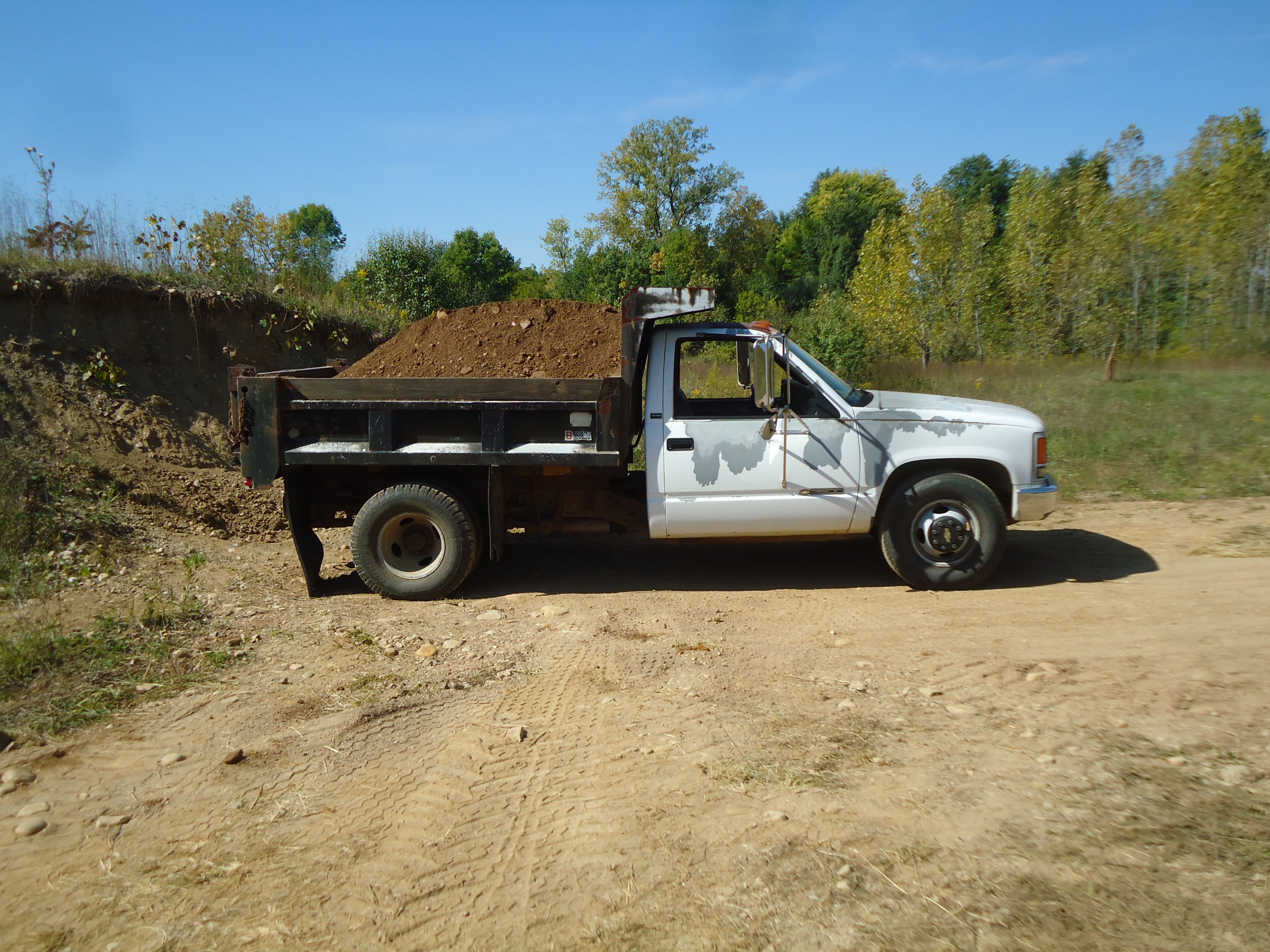

Glad to be of help. They are a handy machine to have around. I don't use mine that often, but usually find an excuse to do a few gin jobs to keep things limbered up. But, when I do use it, I use it a lot..!! A couple pics from last Fall. Loaded out over 900 tons of bank run gravel, for a new building pad. Lucky for me it's only 1-1/2 miles away.
Property owner upped the price on me, he sold it to me, for $1.00 per ton 5 years ago. He told me last Fall, he thought he needed more. So price jumped to $1.10 per ton. I told him I thought I could swing that. :)
