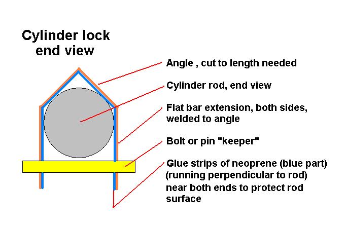

Cylinder rebuild - could you post a pic of what your cylinder's gland nut looks like? Need to see the surface of the nut where the rod comes thru, including any holes. I'm all too familiar with mine, wanna see if I can offer anything on yours or if they're completely different...
I have 7 that need rebuilt on mine, it's gonna be a winter project. Probly got enough things to fix/mod it'll be lucky if it's back together by June :rolleyes: I'll just hafta prioritize the things that irritate me the most, starting with using a LOT less $10 a gallon hydraulic fluid.
Got a pic of what the FEL lock bar looks like? Older ones had no such thing, I keep meaning to build a pair of these -
