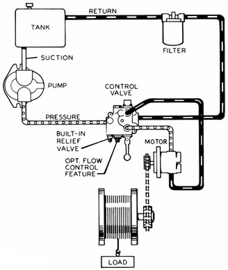

This valve seems like it would work. Has a detent in one direction and spring return on the other. I think if it were plumbed so that the main drive had a detent and was in the forward position of digging, it would be good to go. The spring return side could be used to reverse the chain to clear an obstacle or rock, but not held by a detent. Thoughts?
I am also going to need some help in plumbing this set up from the old. I bought a new pump yesterday, 13 spline, SAE B hydraulic pump. I figured to hook it up with tank input as the old pump was, pressure to the spool and then to the motor as it would be for forward and reverse. However, there are hoses in and out for the hydraulic cooler. What side of the pump/spool should they be?

I am thinking this is the diagram to follow, I just don't know where to incorporate the cooling lines.

what size pump did you order or what the flow be at operating RPM? You need a valve sized to handle the full flow rate. The ”Brand” valve is 8 GPM but appeared to have the correct features. The Walvoil was not detented.
on the cooler it would be in the return line from the directional valve and must be of adequate size to handle the flow. I typically recommend putting them between return filter and reservoir. This keeps dirty oil from clogging the cooler passages. Also recommend cooler by-pass valve for cold oil. Normally around 30 PSI by pass is used for cooler. Simplest is a check valve in parallel with the cooler.
