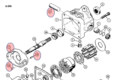

No change. The gauge moves just above 100 and that's it
   / Case DH4B Trencher/Backhoe Won't Spin Trenching Chain #52
In both directions?
   / Case DH4B Trencher/Backhoe Won't Spin Trenching Chain #53
R8
Can you physically see the control shaft on the pump? It should rotate approx 15 degrees either direction from center.
#54
Yep, it moves. I can see the shaft moving. Both directions, no difference. It is low on fluid, so I am going to add more before I condemn it, but I have a feeling the issue persists. Is it possible that the lever isn't turning the shaft enough? Like it is staying in between neutral and forward/reverse. I am waiting on a new control cable, hydraulic fluid, a tire and one hydraulic fitting. Once I get all of my supplies, I will give it another go. Right now the machine is in my shop and I would prefer to test everything outside. I also pulled the thermostat out and it was pretty plugged up. I want to get the cooling system nice and clean as well since there is a HUGE oil cooler in front of the radiator and I'm sure that plays a role in keeping the fluid in good shape.
   / Case DH4B Trencher/Backhoe Won't Spin Trenching Chain #55
So there is only 2 possible explanations to what you have happening.
1. The pins (12) that attach the shaft (6) to the swashplate (11) have either sheard off or fallen out. This would cause the swashplate to remain in a neutral position, even though you are rotating the shaft.
2. There is a tremendous leak somewhere else in the system.
Are the system hoses from the pump connected to the motor?
If they are, the next step I would do is cap them and try to stroke the pump. I would do this right at the pump so there are no other potential leak paths availble. This is a "dead head" condition so the oil will immediately go over the relief valves which are probably around 5500psi. You should immediately hear the pump whine and the engine should labor. Do not fully stroke the pump since those valves aren't going to be happy with full flow going across them. I would also make sure you take out the 600 psi gauge because in one direction it will be destroyed.
If it passes this test, then the issue points more towards the trencher motor, not the pump.

I would say that there isn't a big leak in the system. The reason I say that is there are 3 pumps on the drive plate. The left hand pump runs the excavator and the boom lift of the trencher. The middle pump runs the drive wheel and steering. The RIGHT hand pump, our troubled one, runs the trencher motor and the backfill blade. The back fill blade does NOTHING. I would think if there was an issue with the trencher motor, the blade would still work and vice versa. My question is, should I wait to try the system again with all the oil, or should I go back and remove the oil that is currently in the system and pull the pump out to check for the pins? Are they roll pins? Do they commonly shear or fall out?
