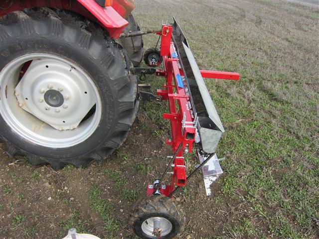

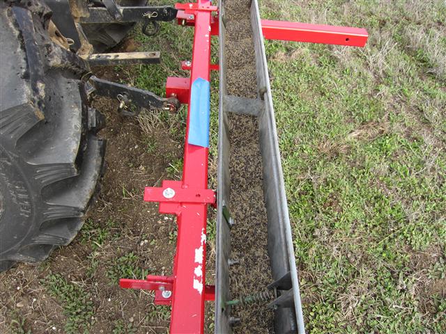

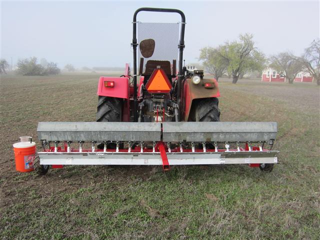

Unless that drill comes with grass seeding boxes, it won't work for alfalfa seed which is very small size seed. You can plant larger size seed (oats, wheat, etc) with the fertilizer box on that Case drill. My neighbor farms 30 acres of irrigated alfalfa and uses an old Brillion grass seeder for planting.
A few years ago I bought a pair of old Minneapolis Moline P3-6 grain drills (10 ft wide, 20 drops, single disc openers, $275 for the pair) and restored one of them using parts from both. Plant oats with the large box.
This year I planted a cover crop of lana vetch/annual ryegrass (both have small seeds) using two of the 5-ft wide grass seed boxes that came with those MM drills. I want the seed to be dropped uniformly in a line about 10-ft wide instead of in rows 6" apart which is how they work when attached to the MM drill. So I built a custom drop seeder using those boxes.
