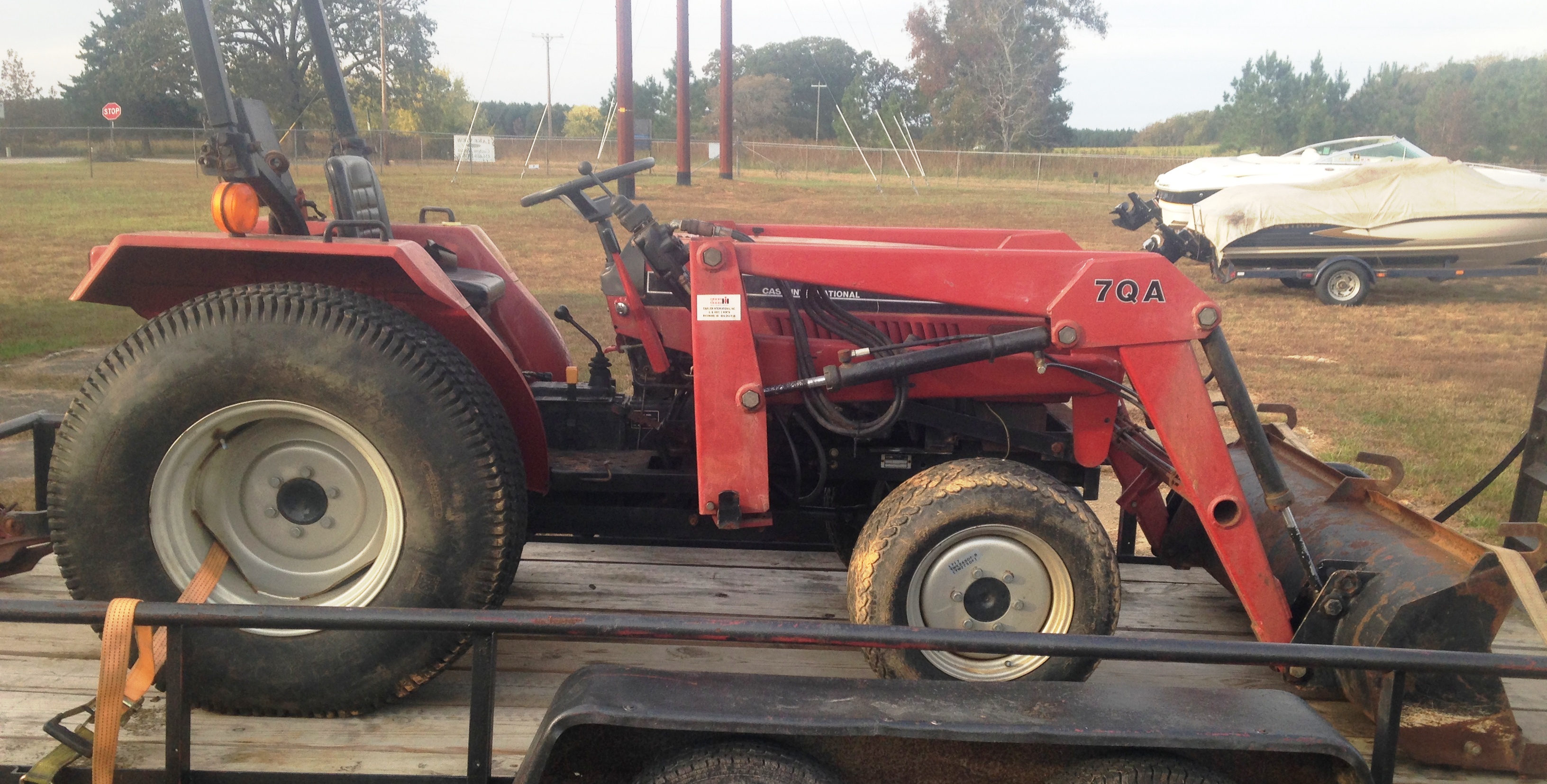

Picked this tractor as a project to work on this winter. Severely overheated engine and missing radiator. 273 hours 4x4 and turf tires. Most of the parts I have found are from china. Anyone have any luck rebuilding Mitsubishi K3E diesels that have been run hot. Center piston is trashed. Will have to pull the motor to see how bad the cylinder looks. The tractor still ran before the head was removed but the it was filling the crankcase with coolant. Owner and the mechanic decided they didn't want to invest the time or money to try to fix it. I have found some running pull out K3E motors for $1500. Going to tear this one down to see if it is salvageable.

the radiator might be hard to find, but I would look in salvage yards for a 244 / 254 / 255 international.

I have found a Mitsubishi parts Tractor that has a radiator and some other pieces I could use. I believe it has the K3H motor. It had the same issue but the pistons are stuck in the block. It actually has a belly mower that would work nicely on my 255.

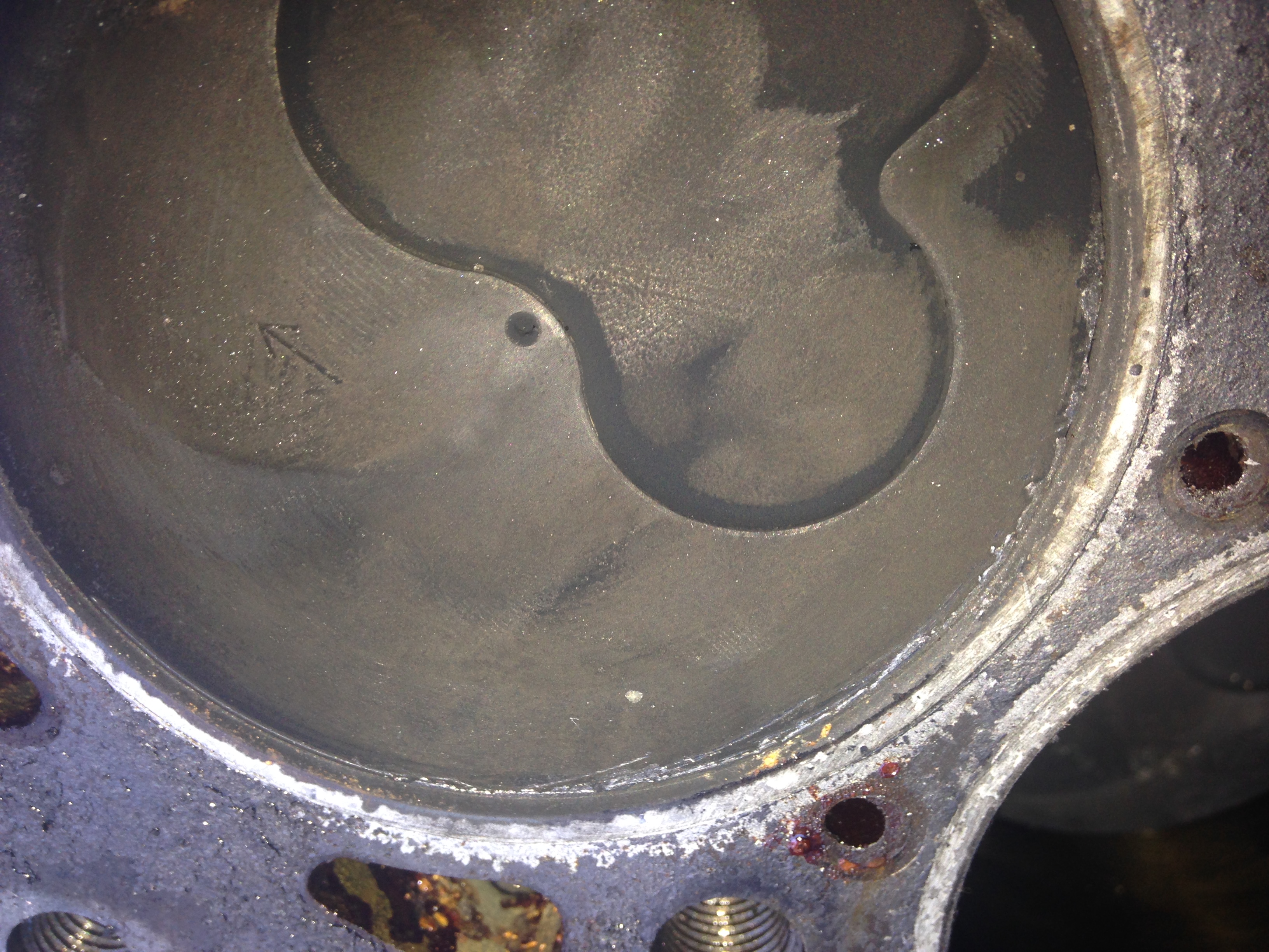

Got a chance to pull the head today. Only the center cylinder has aluminum stuck to the cylinder walls. one and three look decent but two has stuck rings. Will have to pull the pistons to really know how bad the pistons are mucked up. The cylinders look good with no ring ridge. Just some aluminum in #2.

Got the pistons out. Cylinders one and three show no signs of damage. #2 is scuffed up up pretty good. I found some parts for the repair from a company in Las Vegas. NCW Tractor Parts, LLC Anyone ever had any dealings with them? They have a much better parts selection for the K3E than Weaver. Not sure if they drop ship from china or have an actual US warehouse. Will find out next week I guess.

I bought some parts from them, and they shipped fast. That's the best I can tell. But I never ordered engine parts from them.
Your pistons looks waaaay better than mine did for darn sure. You should be able to get it back together rather easily.

Thanks I am waiting on the piston to get here before I order any more parts. I am thinking the #2 cylinder may have an injector stuck open. Going to test them once I get it put back together. I still have to pick up the other tractor to get the radiator. Still not convinced it was run hot. 1 and three show no damage. all the damage was in the #2 cylinder. It did spring a leak in the radiator but it was gone before I got the tractor.

Got the cylinder honed today and the gasket surfaces cleaned. Parts from NCW Tractor Parts, LLC were sitting on the porch when I got home. Four business days from placing my order is not bad. Tomorrow I am picking up the donor tractor for the radiator. I hope to get the piston in it and get it put back together tomorrow afternoon. Need to test the injectors also. Will try to get some shots of the donor tractor tomorrow and post my progress tomorrow evening.

I only bought one piston. The other two were not damaged. There was no ring ridge. The motor has less than 250 hours on it. Only honed the damaged cylinder. The damaged cylinder is the only one getting new rings. The replacement piston does not have the valve reliefs like the factory pistons. It will be interesting to see if there is any difference in static compression. I also want to get a weight comparison between the two pistons.
