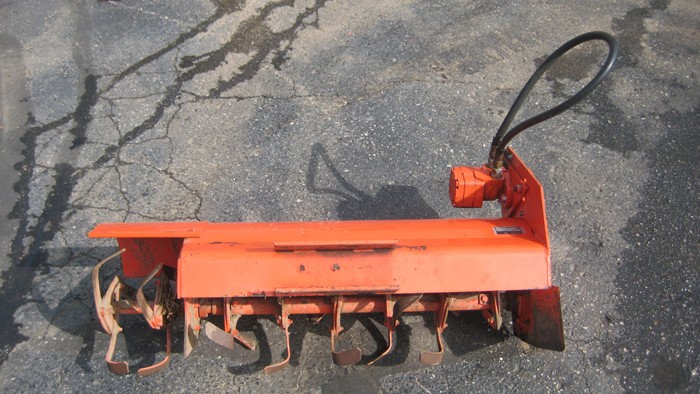

My latest score on attachments to modify and adapt for my PT-425 is one of these hydraulic tillers for a Case or Ingersoll garden tractor.
It has a hitch that originally pinned on the tractor's 3PT hitch bar. I'm trying to design something that I can put on a PT QA plate that will allow me to pin it on so that I can offset it to ether side to till out my wheel tracks. It is only 41" wide, and my track is now at least a foot wider with the large 28ci wheel motors I'm running.
I picked my tiller up for $400, shipped and delivered - a cool $1000 less than a new 48" one. Hope to get it modded in the next few weeks, ready for spring time gardening... Note that these are pics from the 'Net. Mine is actually white, and has a complete shroud, not missing the piece in the one pic.

Does your PT have enough GPM's to run the tiller?
It will probably turn it regardless of the GPM's.
What's good about hyd tillers is that you can do a reverse till..
   / Case-Ingersoll Tiller for a PT?
The 425 PTO pumps 8 GPM at 2500 PSI. I think -- not sure -- that the spec for that tiller is 10 GPM max. It is for their 10-14 HP tractors.
   / Case-Ingersoll Tiller for a PT? #5
If their tractors are 14 HP, they can pump about 8 GPM at 2500 psi, so you seem to have a good match for your 425.
