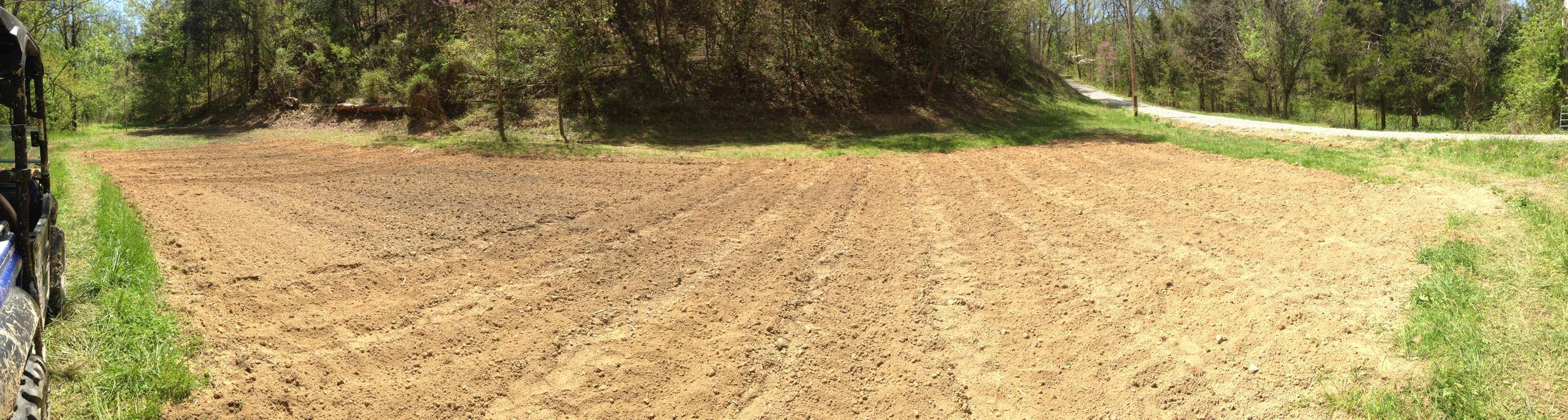

Got my first chance to use this today, so I thought I'd provide some pics. It's not as pretty as some of the pics I'd posted from the web earlier...
Since the tiller is not as wide as my PT's stance, I made the mount so that I could offset the tiller to either side, and adjust its offset in about 3" increments using the original mounting holes:
This garden spot had not been plowed or tilled in at least 3 years, and it was still a bit too wet, but I was getting impatient. Results of first pass:
After a second pass:
Overall, I'm quite pleased with it, on my first use. Once I get more familiar with it, and perhaps learn how to back up an articulated machine in a straight line, it will work just fine...

Radishes, cucumbers, carrots, purple and yellow onions, potatoes, okra, cantaloupe, watermelon, pumpkin and zucchini, crookneck & buttercup squash, and marigolds planted. Now to get the tomatoes & bell peppers in the ground.
