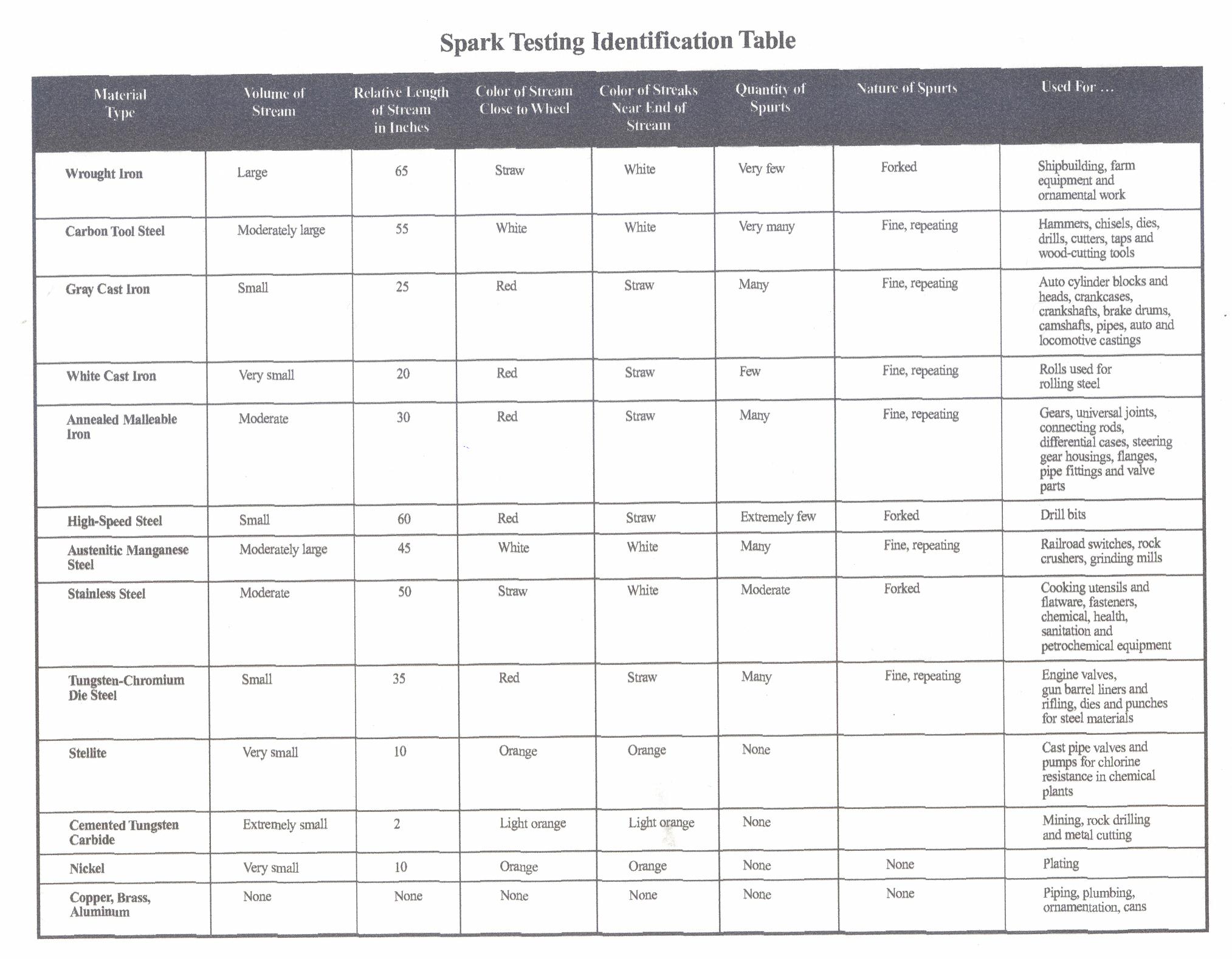

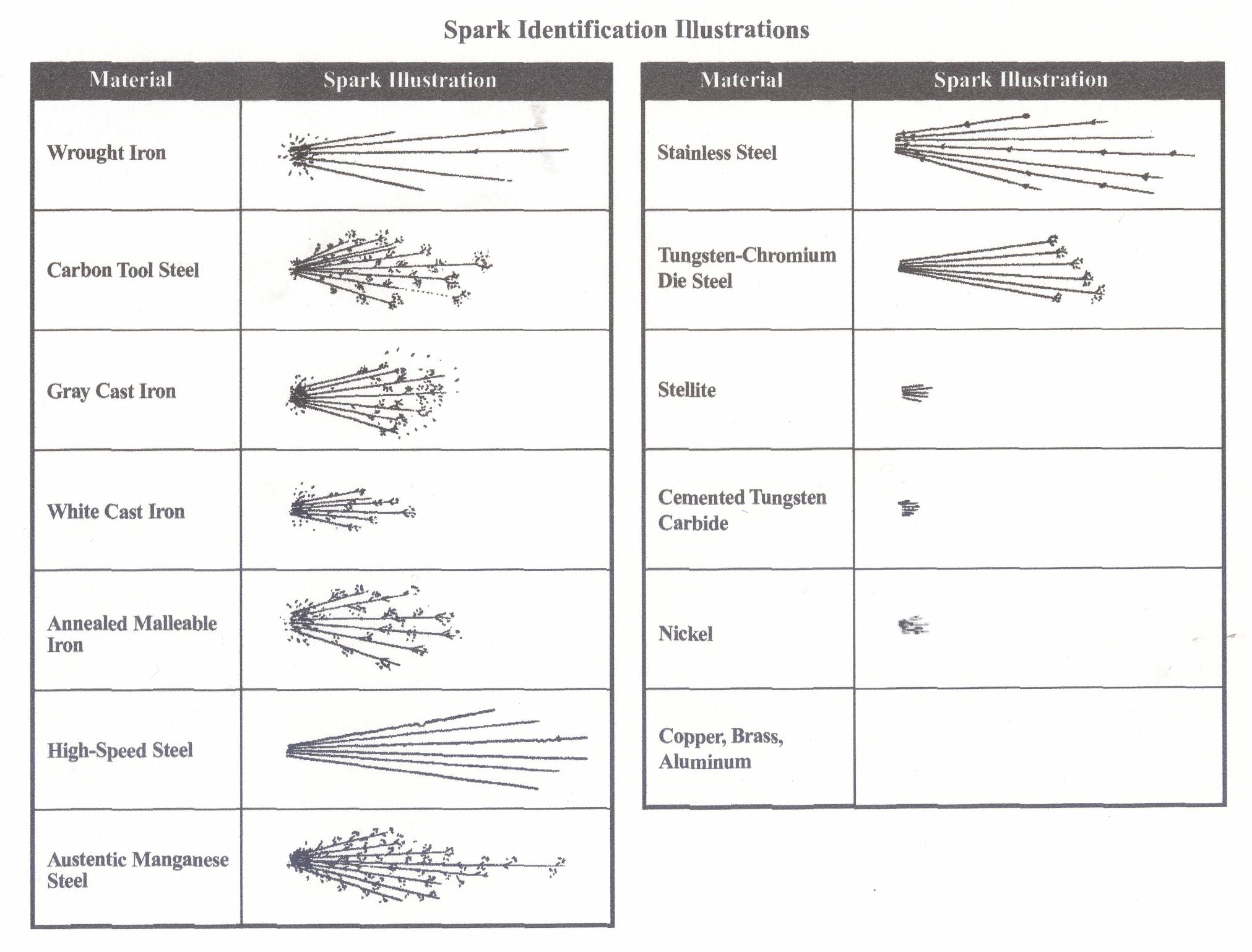

Cast Iron or Cast Steel? Is there a difference in the welding/machining process?
From my limited understanding, they are quite different materials but often the name is used interchangeably. How do you tell them apart?
Here is one way.

Thanks for the chart, that will be helpful.
If I'm reading it right (and I'm not in the shop to confirm) an engine block is cast iron (don't weld unless you are a pro and following strict procedures) but a truck differential is likely annealed malleable iron. Is a different process required or would a standard mig welder be good and have at it?
