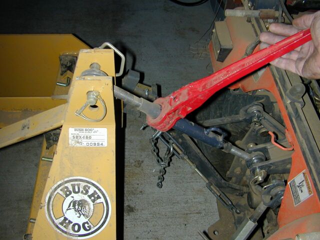

Depending on your barrel diameter, the ratchet portion of the load binder (5200# working load size) can be removed by driving out 2 (tapered) pins. The ratchet ID fits over the major diameter of the stock BX23 barrel. And, will fit the minor diameter ( the part of the barrel nearest the ends) of the after market replacement top links sold most everywhere.
Though this works pretty well, I've found that after adding gauge wheels to my implements, I don't need to adjust the top link much.
Cheers!

Well, to avoid having to look at my own welding in the future, I'm having Bill Thomas' Redlandhill shop in North Carolina whip one up. He's basically cutting the ends off one of their Cat 2 Vertical Lift Link Ratchet setups and welding on new Cat 1 end balls. Final overall length and adjustment range will be almost identical to my current stock top link. Ought to be **** for stout, too, since it's being built from a Cat 2 lift link.
I checked at Atwoods this afternoon, and at $19 + tax for a new ratchet jack, and $8 each + tax for weld-on end balls, I was looking at almost $40 for materials alone (couldn't re-use my old top link, the threads show a lot of wear and the end balls are rusty and getting a little loose). Bill is building me one for $49 plus about $10 shipping to my front door. Hard to beat, far as I'm concerned, and other than the shipping, I don't think I could have it done any cheaper down the street here. Of course, I'll still have to paint it Kubota blue, but that I can handle. I'll post a photo after I get it installed if anybody is interested.
Thanks for all the input on this. I'm new on here and learning a lot from all you guys.

Danged if I know the max loads, but I'm modifying this one out of 1" mild steel rod, had to add 3-1/2" to it after I got it because I have since added a quick hitch that adds a few inches to the length of the lower links, which made the ratchet top link a tad too short. I just finished painting the modified version, will add photo and short report when I've tried it out, not that it's all that beautiful to look at. I'd think a short length of 1" rod is fairly stout for Cat 1 use, but we'll see.

Any kind of hydraulic setup would certainly be nice, but probably too fancy for my old rig. At the website below (www.w5kp.com) are the final photos of the ratchet-adjustable link I came up with. It works, and I have about $50 in it, not counting the time to grind and clean up my crummy welding. I'll bet none of the hydraulics rigs can match the price! /forums/images/graemlins/smirk.gif

Finally had time to do some box blading today, so was able to give the new ratchet-adjustable top link a workout. It worked "slicker'n duck snot", as my grandpa used to say. I even found out that using it from the operator seat "on the fly" was easy and worked like a champ. One caveat: When you are through adjusting, make sure you leave the handle in any position EXCEPT straight up. The handle on mine is cut pretty short (you don't need much of a handle to have plenty of leverage to easily work the ratchet). The end of the handle won't quite reach the back of my seat with the hitch fully up, but it comes pretty close. If somebody neglected to cut the handle off enough, it might get exciting because if you leave it in the straight up position, then depending on your tractor's configuration it could goose you in the caboose when you lift the 3-point all the way.
Overall, I'm pretty pleased with this setup. MUCH nicer to use than the old link, and almost as handy as a hydraulic top link, for about 5% of the outlay! I'll spend the $500 I saved on some additional remote hydraulics for my next tractor. /forums/images/graemlins/grin.gif
