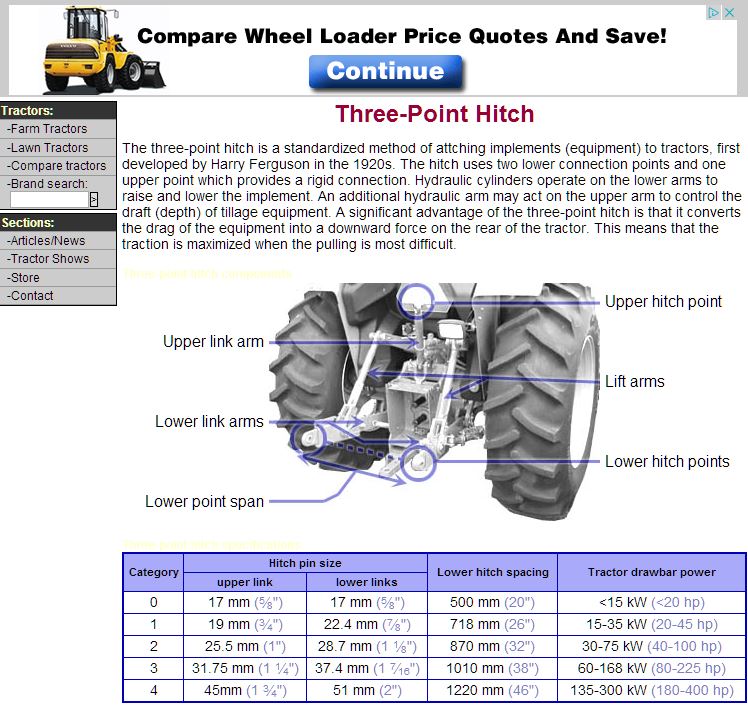

I have a New Holland tractor with Cat1 three point hitch. A friend has given me some implements with Cat2 hitches. Where can I purchase Cat1 to Cat2 pins or is there another way of using the implements?

I don't know if you've tried to hook them up to your tractor yet or not but for some cat 2 implements, there is more than just the pins that is different as the width of the cat 2 is wider than cat 1.
The lower lift arms on a three point cat 1 hitch are 26 inches wide. A cat II hitch is 32 inches wide.

I believe Cat I comes in two widths it is 26 inch for the smaller tractors and 32 for the larger tractors.
Actually Cat l 3 pt hitches only come in one width 26"s
