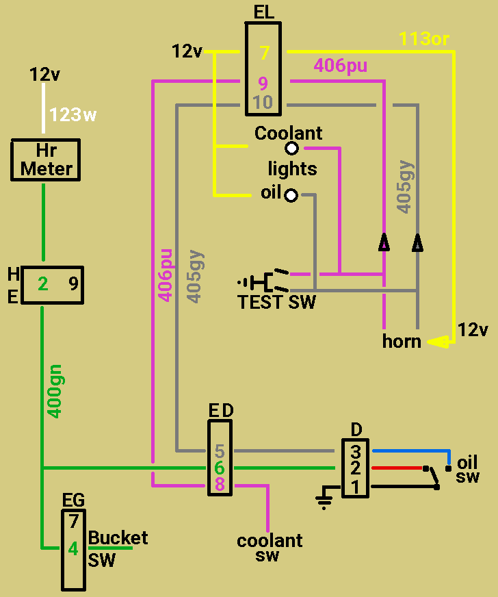

Thanks,
The oil pressure transmitter/gauge is aftermarket and was validated when installed with a mechanical gauge. I know of no oil-level sensing as such on the engine. I presume it's the original oil-pressure switch that trips the oil-pressure red light and the horn. I had this before momentarily with extreme nose-up attitudes a couple of times but NEVER with a concurrent transmission cutout. The problem is I cannot find the Pr-Sw or its pigtail, some books show it on the oil-filter adapter but mine has nothing there.
if you mean the oil-pr-switch I can't find it, nor the wire going to it

Just because you can’t find the oil pressure sensor doesn’t mean it’s not there. Every engine has an oil pressure sensor. A one cylinder ya mar even has an oil pressure sensor. Given your symptoms it sounds like that’s your problem. I understand you’re not a mechanic but you can’t just decide your problem is way more complicated than it is simply because you can’t find the sensor. Find the sensor and make 100% sure it’s functioning correctly before moving on to other things. Keep it simple. Having three different unrelated problems happen at the exact same time is extremely unlikely. Especially when all of those problems are exactly what an engine does when it thinks it doesn’t have any oil in it to protect itself.

I certainly intend to find it if it's there or to know for sure that it isn't if it isn't :) Just made myself a simplified wiring diagram to help with the TS, though the real wiring isn't exactly the same. It's a 32 year old rig so the wiring isn't in too recognizable a condition in places. The issue of lettering on the diagram connectors BTW means the harness names. One of 3 coolant sensors seems to share the D harness that I need to find, I'll try to backtrace from the engine bay, the E harness from the dash is mostly in a door pillar impossible to follow (to it). I might get on that this afternoon or tomorrow.

Resolved!
The last pro who has been working on the machine for 10 years also installed the pressure gauge and had then decided to MOVE the presure-switch to the tranny filter. The horn went off a little late each time to be an 'alert' when a dirty strainer caused a self-induced vacuum leak. The strainer was last replaced in 2006 by the former pro who now has the ball again. I'm not equipped to do anything on trannies so I didn't even try.
