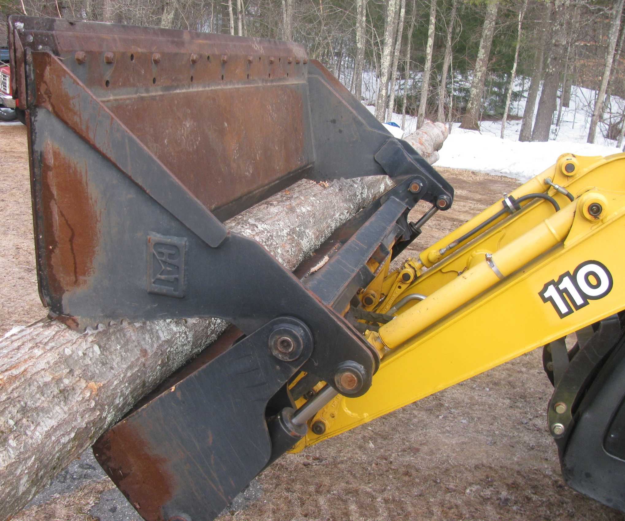

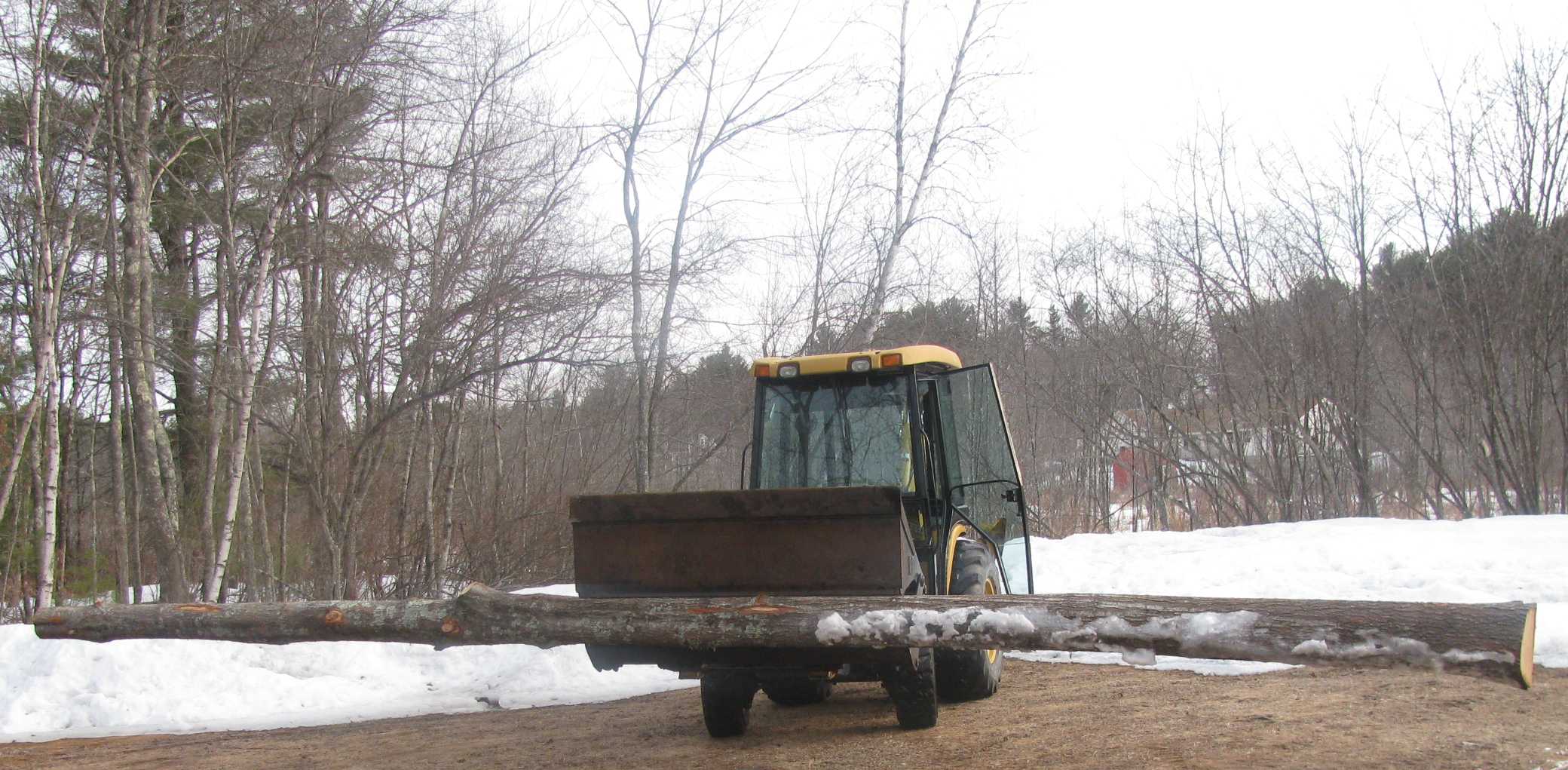

Grappling logs with John Deere 110 and Caterpillar 4 in 1 78" bucket. Log is 32' long, green red oak, weight approximately 2375 lbs.
