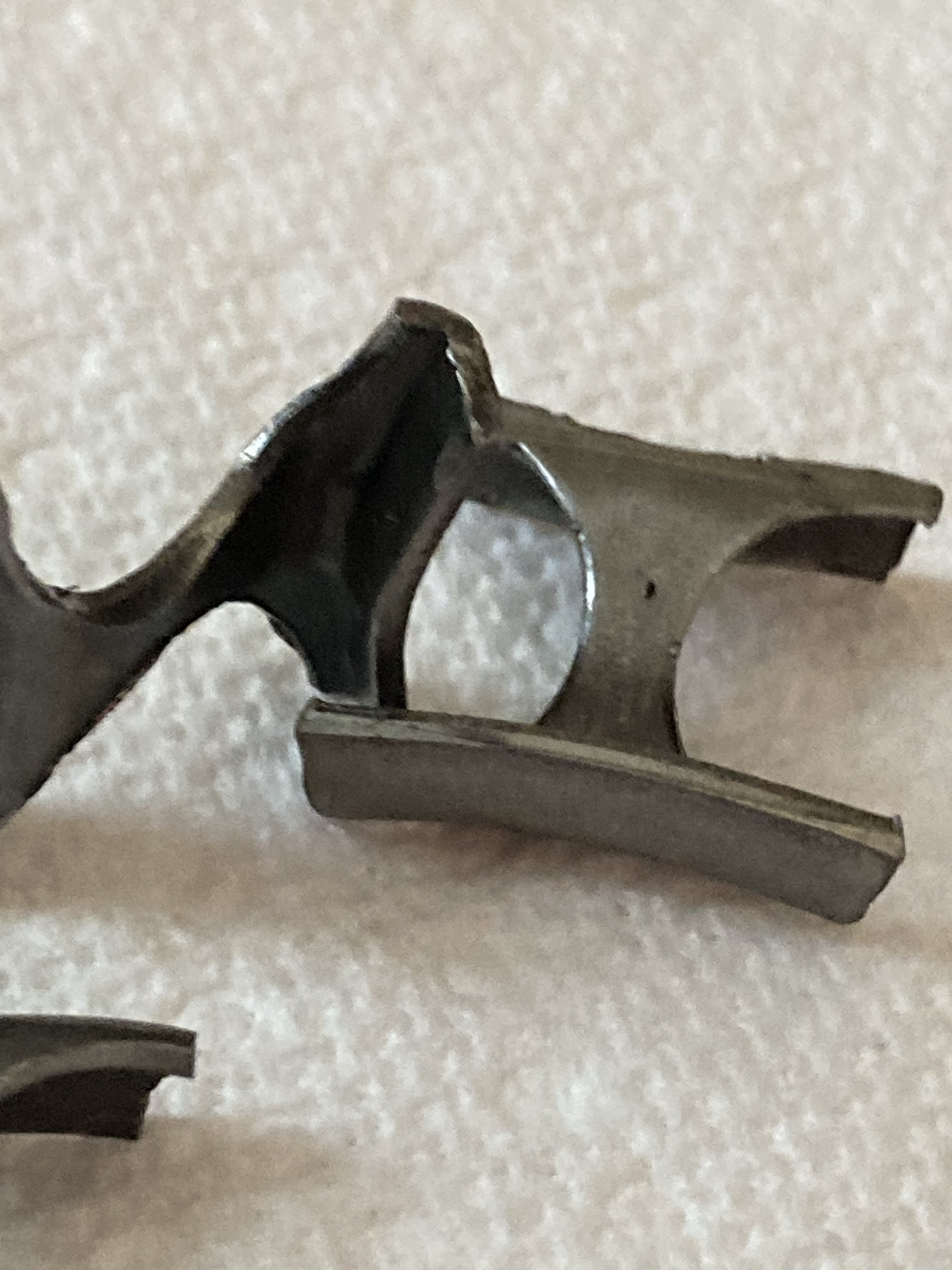

I own a Cat 951B Traxcavator. While cleaning the Steering Clutch Oil Screen, we found 6 metal objects in the screen; each one is about 3/4" x 3/4"
. Photos are attached. Does anyone know what these are and where they go? We haven't been able to locate them in the Cat service manual.

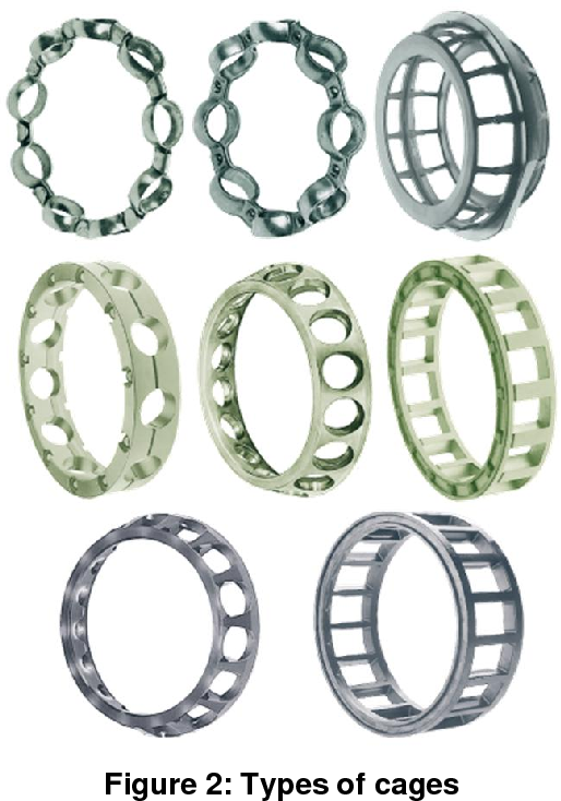

Kind of looks to me like bits of a ball bearing cage
Thanks for your quick reply. I agree they somewhat look like a bearing cage. However, they were found in the oil screen for the bevel gear and steering clutch housing. I haven't seen any thing in Cat's drawings for my machine that resemble the pieces. However, I'm still looking. Don't want to tear into this thing before I know what I'm looking for.
