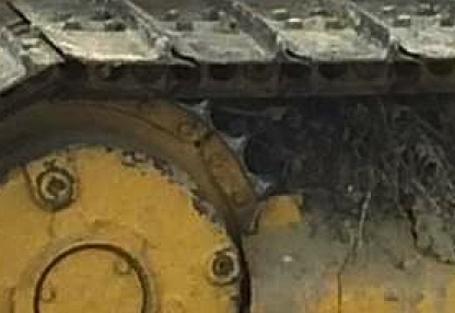

I agree the sprocket looks worn. Thank for your input.
A full track job is not cheep. I really want a machine with 2000hrs, but this one popped up in my area set up like I want it.
At 2000 hrs there is a whole lot less worn out. I figured I could run it at least 1500hrs as is and do a full aftermarket track job.
I don't think I would count on 1500 hrs. in my part of the country, just judging by the sprocket I can see. Maybe I'm just hard on them.

Enhanced a bit:

They are segmented sprockets for easier replacement . They did not mention that in the report above, the wear on sprockets. Should I insist they change the sprockets? In a perfect world I would request a complete under carriage, but that is probably $12k
