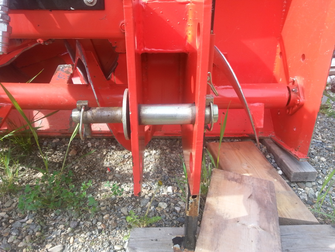

Re: category 2 to category 1 pins, here is a photo of my Meteor snowblower with such pins mounted facing inwards as others noted:

In my case, the lower hitch mounting holes are bored for 1-1/8" (Cat 2). Category 1 pins (7/8") are sloppy loose in the mounting holes. I had hoped to find a cat 1 to cat 2 conversion pin. If one is made, I would like to hear of it.
You should be able to get cat 1 pins with 1 1/8 threads, if you have trouble finding them just use a bushing the thickness of the mounting tab to reduce from 1 1/8 to 7/8.
