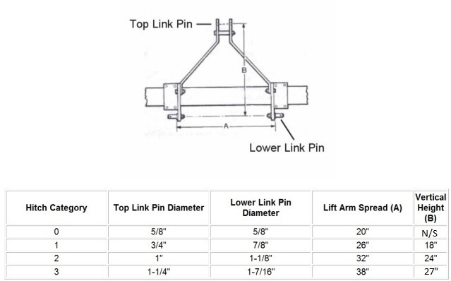

So what category of tractor is my GC 1710,to buy 3 point attachments
/ Category #2
Cat 0 or limited Cat 1. Most cat 1 implements will fit
/ Category #4
Here are the dimensions:
Dimension for Cat 0 top link vertical height (B) is not specified.
/ Category #6
Category 1 limited is the official designation due to limited vertical travel vs larger tractors. There are many "sub compact" made category 1 implements out there now given the explosion in popularity of SCUT's (sub compact utility tractor). Everythingattachments.com makes a line of Land Shark branded implements and of course there Land Pride which has an enormous partnership with Kubota. I've seen orange colored sub compact stuff at the big box stores like tractor supply co, runnings and Agri supply as well.
/ Category #7
I had a limited Cat 1 rear blade for my 1710, I actually had to shorten the turnbuckle bolts to get it tight.
I haven’t found a regular Cat1 implement that doesn’t fit, yet.
/ Category
Thanks everybody,the charts really help
